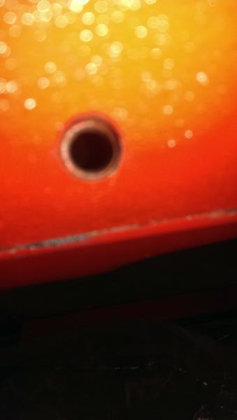

I now have the plug out. I had to push it in and left it in the bottom of the oil pan. It appears to me that there is a sleeve in the hole (see picture). I assume I will need to knock this out too? For the dip stick to fit properly?
Posts: 6.1K, Visits: 441.8K
I think that is just a counter bore. I can look at a block tonight.
See if the dipstick tube goes in. The dipstick tube is a very close fit so it should not just drop in but it should go in fairly easily. If it does, then it is not a sleeve. If it just falls in or will not go in at all, then there is a problem.

It is only a counterbore for the rear sump location.  I verified on some spare blocks.  So no sleeve.  DO NOT try to get it out.
