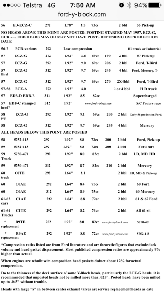

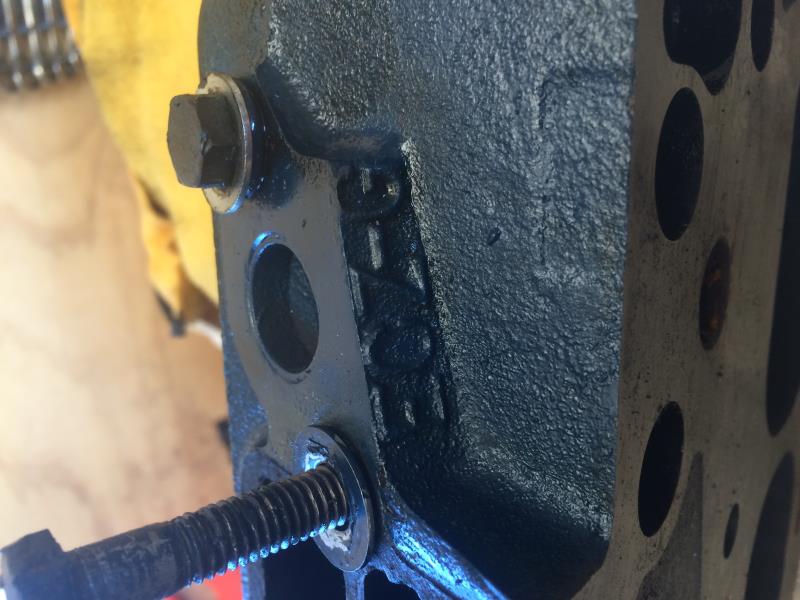

Dan.  I missed your posting on the last page.  Let's determine whether the ECZ-G head that you posted the picture of is posted or un-posted.  If it's un-posted I can match it and it'll be yours for the shipping expense.  IF it's an un-posted big letter 'G' series, I'm sure I've got a driver's side head that has not been previously milled and has no pitting on the deck surface or in the combustion chambers.  Valves will be original Ford and margins will suggest that they haven't been ground before.  Probably easiest to ship the head assembled with springs, retainers, and keepers.
See what you've got, Dan.
http://yblockguy.com/techtips/postedheads.html

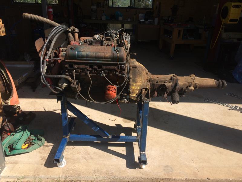

I have noticed the great support this forum has. I think it's unreal, there is know way I could learn what I have learnt in 6 months without this website and its generous members. I remember posting when I first got the engine six months ago, with photos pointing at bits and pieces on the engine asking what's this, what's that?! Unknown to me at the time Ted was one of the first to reply, later on I just happened to stumble upon an article wrillen by Ted and I thought... Hold on a second... This guy is building some of the fastest yblocks around and he just answered my post telling me I was pointing at a road draft tube!!!! Unbeleavable!.
So anyway thanks for the support.
I'll throw up a few pics if anyone wants a look at what I'm doing.

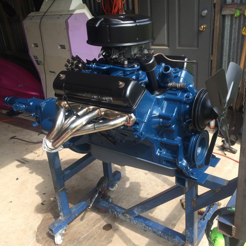

Engine when I got it
http://forums.y-blocksforever.com/uploads/images/28ede058-3a38-4d50-8bb0-d837.jpg

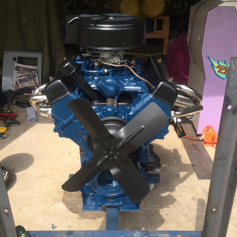

Coat of paint and some headers. (This is before I knew anything, just thought I couldn't hurt with a clean up and a coat) reverse rebuild!
http://forums.y-blocksforever.com/uploads/images/b4b46971-2db4-4199-b2e9-4abb.jpg
http://forums.y-blocksforever.com/uploads/images/da639d1c-fbe7-4946-b576-6d92.jpg

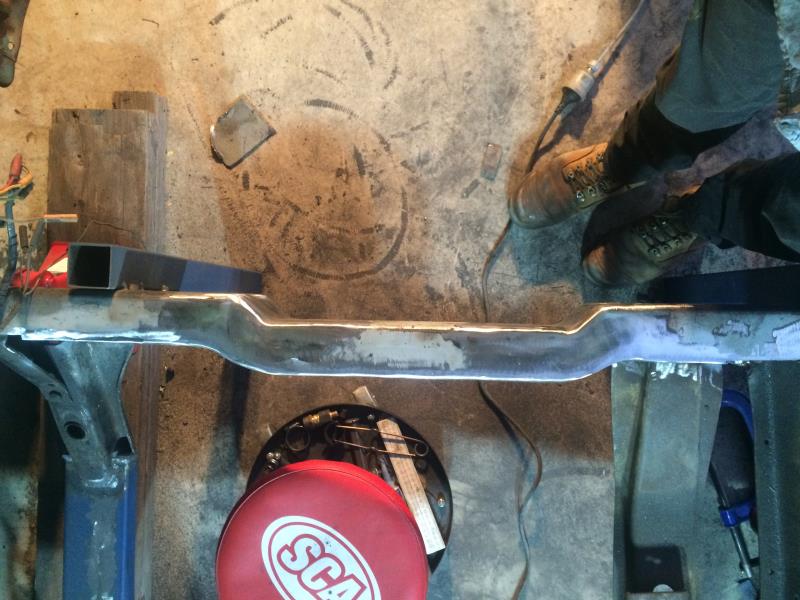

Stepped the frame in to fit the Jag IFS nice and comfortablely.
