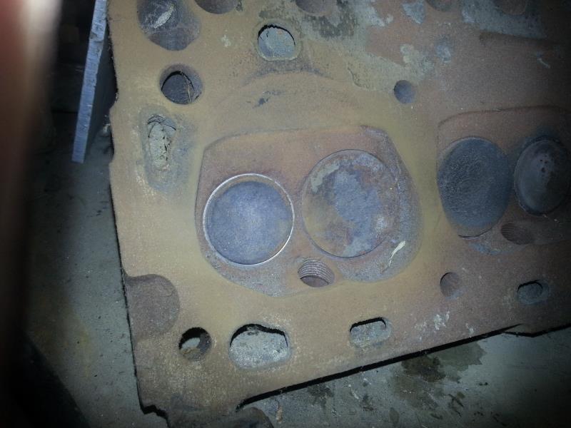

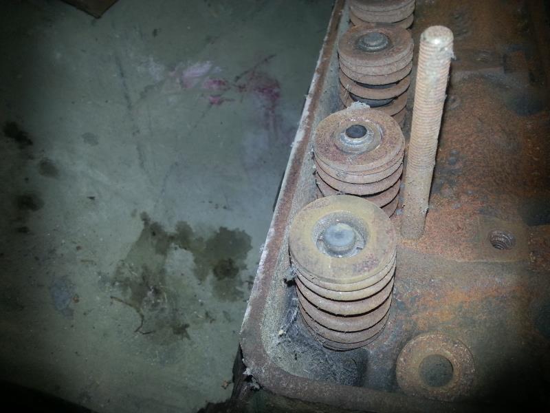

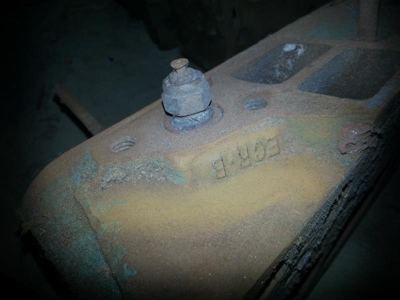

Here is one that I have at home, I think its a 7/16 stem (I should know but don't) I drill them out and install a cast iron guide.
http://forums.y-blocksforever.com/uploads/images/69b31c2d-9800-494b-b928-aa6d.jpg
http://forums.y-blocksforever.com/uploads/images/4921d98c-8b28-41e9-a523-cb36.jpghttp://forums.y-blocksforever.com/uploads/images/84e4d8bf-cb0f-438d-8470-3975.jpg
