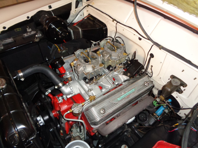

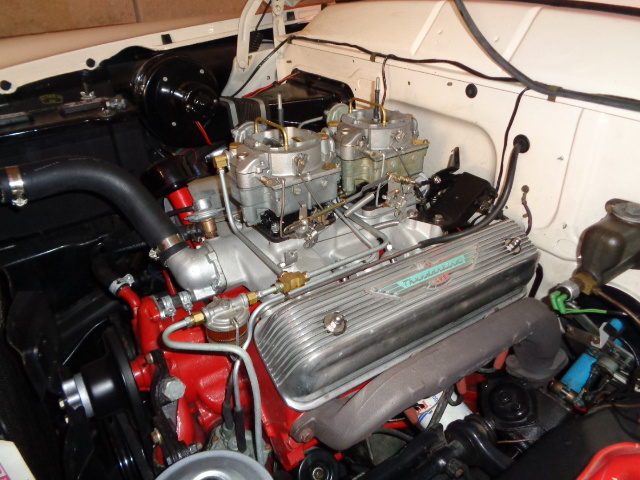

Posts: 1.7K, Visits: 340.0K
When I received the manifold I bought it had 2 of the adapters on it that allowed you to use the Carter AFB's ( the smaller the better) or Edelbrock replacements. I chose the Carter WCFB small base carbs for mine. Good luck
