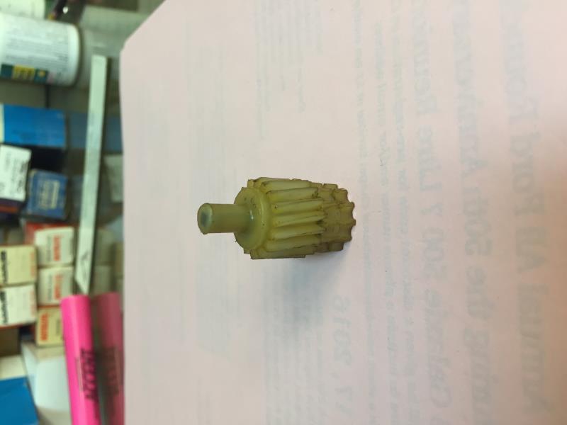

slumlord444
Last Active: 4 Months Ago
Posts: 1.2K, Visits: 137.2K

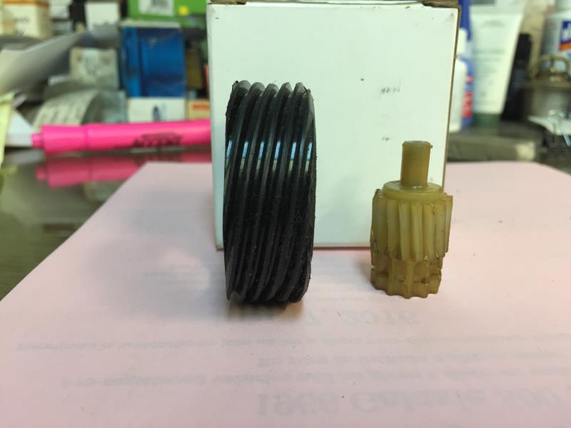

The pictured gear is opposite of the previous described gear and opposite of mine. I am assuming that the gear in the transmission is steel. If my gear is angled in the wrong direction it would not go in or would show damage when I took it back out. Now I'm confused again?
9310alloy
Turbocharged (65 reputation)Turbocharged (65 reputation)Turbocharged (65 reputation)Turbocharged (65 reputation)Turbocharged (65 reputation)Turbocharged (65 reputation)Turbocharged (65 reputation)Turbocharged (65 reputation)Turbocharged (65 reputation)
Posts: 30, Visits: 180.9K
Hello.... This is the two helical angles you need with your Toploader passenger side speedo load Torino 429 housing. Tail casting # C9OR-7AO40A...Your driver gear is plastic on main shaft like the driven gear gear on speedo cable. You will chew up both gears if helix is not correct. Double check what is on your main shaft ?? Lots can happen in rebuilds 40 plus years later. Most 429 Torinos came with 7 tooth driver (black gear). Double check what you really have... Hope this helps.... Mike
