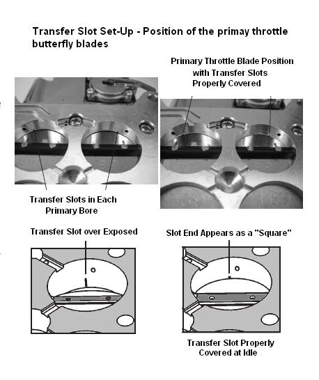

I have this setup on my 56 with 292 and Fordomatic and it works great. I used 56 main Jets and switched the inlet Needle+Seat to all Steel as used on non Gas Applications. I do have a Fuel Pressure Regulator because Holley Carbs don't like a lot of Fuel Pressure. Later Distributor modified with light Springs for full Centrifugal Advance all in by 2500 RPM. 8 Degrees initial Timing Advance, 8 Degrees Max Vacuum Advance, and 26 Degrees of Centrifugal Advance. These 390 CFM Carbs are a very good Carb to use on a basically stock 272-312 Engine. It is very important to initially set the position of the Throttle Plate so that no more than a Square of the Fuel Transition Slot shows below the Throttle Plate. This is adjusted using the idle Speed Screw. If more than a Square of the Transition Slot is exposed You will never get the Idle Mixture Set properly. Fuel is being drawn from transition Circuit if more than a Square of the slot is exposed. Resist the Temptation to turn the Idle Speed Screw to get a higher Idle Speed. Initial Idle Speed setting should get the Idle Speed around 550-600 RPM. Adjust the Mixture Screws for highest smooth Idle. If Speed is excessive back off the Idle Speed Screw. Do NOT turn the Screw to raise the Idle speed. My suggestion is start over with the Carb. Make sure the dry and wet Float Level is correct and set the position of Idle throttle Plate before You install the Carb. Make a note of how far to turn the Speed Screw after it contacts the Throttle Lever to get the correct exposure of the slot so You don't have to remove the Carb if You turn the speed up despite the fact that it should not be turned up after the Engine is running. Also because You also changed the Manifold check for any Vacuum Leaks if you are still having trouble getting the Carb adjusted.

Here is an illustration of the idle transfer slot - its set up with the carb off the engine. I know that virtually every person who ever tried to tune a Holley four barrel carb has tried at least once, adjusting idle speed with the primary throttle blade setting alone. Wrong. On these 4160 type four barrels - that is best done by 'tweaking the position of the secondary blades. If the transfer slot coverage is not properly set - you will have a tough time - every time............ Holley used to send reps out to the various speed shops and put on clinics (circa 1960's) - those guys knew how to get an outfit working in a hurry. Now days - maybe U-tube - but experienced Holley tuners know how to do this.
.http://forums.y-blocksforever.com/uploads/images/05e2bbbe-6ba1-4ea8-a74d-18bf.jpgIf you go through the set-up instructions for the Holley 390 carb - it will mention this.
http://forums.y-blocksforever.com/uploads/images/b235235d-a2a2-4e29-aeb3-3fd9.jpg

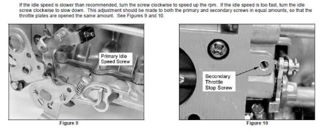

The secondary throttle stop screw is located under the base plate of the carb - visible from underneath when inverted - directly below the vacuum secondary pot's attachment to the rear throttle shaft. There are several methods of dealing with this - and virtually every four-barrel carb manifold intended for use with a Holley has a clearance opening under the base at that location. I have replaced the screw with an "Allen" type set-screw and used that to turn the screw upward with the carb bolted on the manifold. I have bent the tab on the throttle shaft with needle nose pliers (a hillbilly method from my youth). And finally - I've used a long screw of the same size and pitch - cut off to be a tiny bit of "all-thread" and sticking out below the carb flange. It can then be grabbed with needle nose pliers and turned while the carb is in place. Each secondary bore has a single hole where fuel is being dribbled out of the rear bowl - this adjustment provides the idle air for that mixture.
You will also find that the throttle return springs within these carbs - will defeat the springs in the stock auto-trans "kick-down" mechanism - and that will take some tweaking to make it work.
