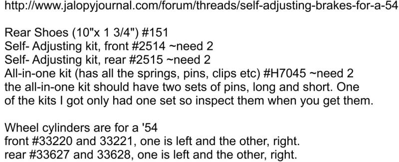

Posts: 4.6K, Visits: 38.5K
This list of parts was up a while back with the kit numbers to convert 54 brakes to self adjusting. Might help. I think the kits for parts are the same. There shouldn't be any requirement for cylinders unless yours are bad.
http://forums.y-blocksforever.com/uploads/images/0ba143b0-a0b6-4a56-8971-2ac2.jpg
