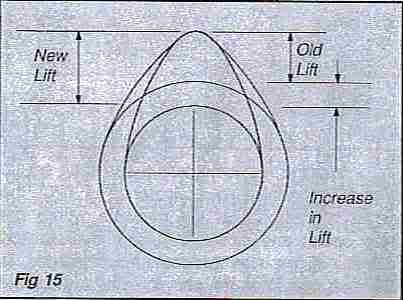

As the lobe lift increases, the base circle of the camshaft decreases.  A .380” lift at the valve camshaft has the same lobe clearance at the cam bearings as a 0.600” lift camshaft.  To get more lobe lift, the base circle is simply decreased.
http://forums.y-blocksforever.com/uploads/images/08cc9007-07d8-4864-977e-9ab1.jpg

Thank you Ted, I think I understand what you are saying. So the 57 cam with the smaller base circle could be OEM?
Posts: 1.7K, Visits: 340.0K
Or it could have higher lift. To get the total lift, subtract the base circle from the total over the nose/base circle. All my non roller GMC6 cams are done this way. The military trucks had steel cams instead of case iron. And we are able to get almost .400" cam lift by the grinding. This multiplied by the rocker ratio can get you pretty total valve opening.

The 1957 oem camshafts with their higher lobe lifts will be cut on smaller base circles than the 1954-1956 and 1958-1964 lower lift camshafts.  If you end up measuring the base circle on the Isky camshaft, you’ll find that it’s even a smaller base circle than the 1957 grind and that’s due to the additional increase in lobe lift.

 Like  Ted was saying  The reason the  wilder can is cut that way is  if the  lobe was made larger there would be a point were they cam wouldn't fit into the block!  I have a ,780 lift cam for a Cleveland that the back side of  lobe is the same size as the shaft itself
