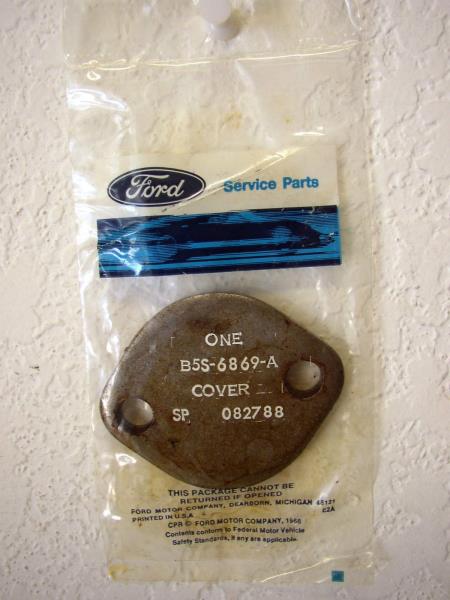

If you want to plug the Hole in the Block where the Road Draft Tube is, a small Cup Type Frost Plug can be tapped in and 2 Bolts plug the threaded Holes. I did mine that way. Can't remember the Plug Size off Hand.
57RancheroJim
Posts: 729, Visits: 112.0K
I used on the these when I blocked mine, guy on Ebay sells them.
