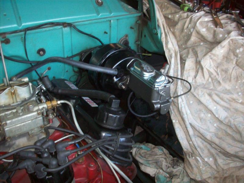

Are you sure that booster came off a Granada,I have looked at 10 in local junkyards and none have that bracket. The ones I have found mount directly to the firewall even with a V8. I had a 70 Torino that had a similar booster setup so it looks like i will not be able to find one so I might have to go with a aftermarket booster. The Master Cylinder (8/13/2016)
Since I used Granada discs and rear brakes I decided to use a Granada Power Booster also...  The bracket is a bolt on  And raises the booster to clear the valve cover.

Picked up a 7 inch booster from a V8 mustang II at the local pull and pay and will make it fit the truck bracket.
