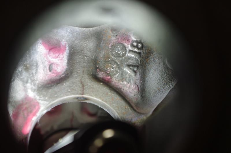

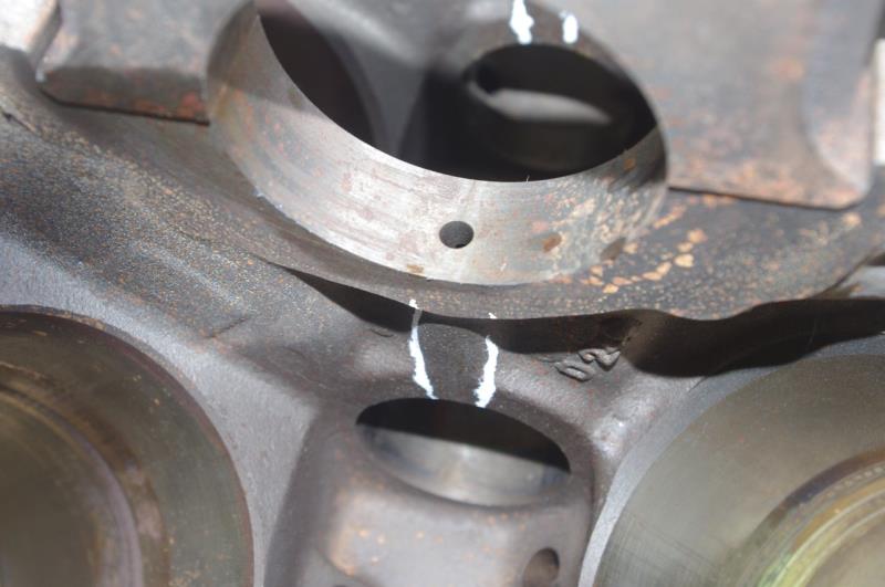

Well I guess another '57 312 block bites the dust, did a dye penetrant test all three webs are cracked. You can see two in this picture.

Ted, Thanks, I think it would be very unusual also.  There aren't any visible cracks on the webs.  I am going to perform a dye penetrant test on it just to be sure, if it passes I am going to call it good.

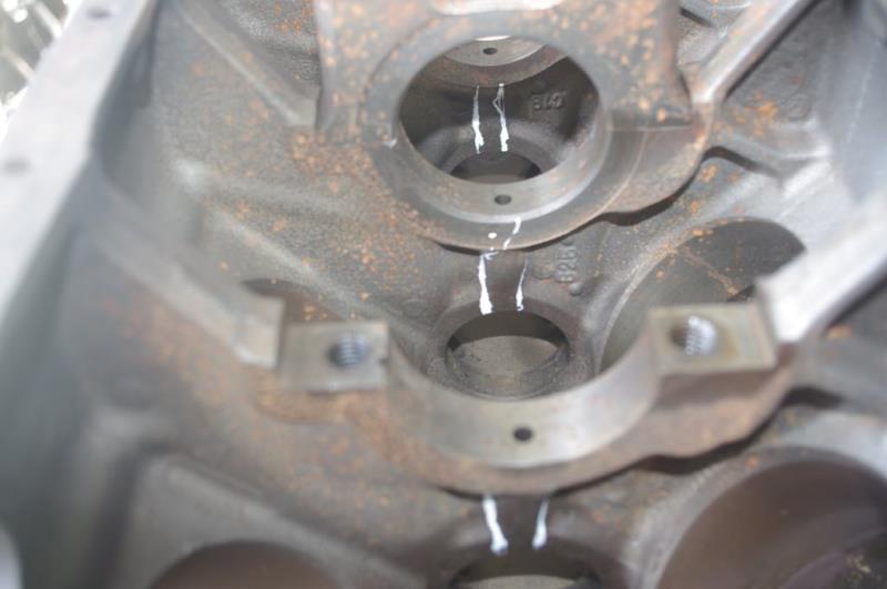

While cracks are known to occur in the cam to main webbing areas, having all three cracked at one time is unusual.  If you don’t see the cracks in the main or cam bearing bores themselves, then the marked areas being cracks is in doubt.  Casting seams can be mistaken for cracks when doing magnafluxing so you have to be careful in interpreting the magaflux results.

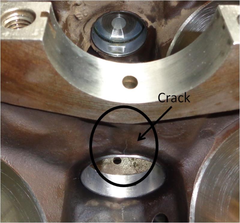

Here’s the picture of a crack that starts at the cam journal hole but has not migrated all the way to the main journal.  This is the #4 main webbing and the other webs were crack free.

Had a '57 312 block magnafluxed, the shop uses wet fluorescent process. Shop told me that it was cracked at the three center main webs in the area of cam bearing feed, a picture of the locations that shop marked is attached.  Shop did say that they did not see anything on either cam or main bearing bores. I have not seen a Y-block show cracking at this location before, but have had many cracked at the main bearing bolt holes. Is this a this a problem area or is there something in the casting that may be causing these indications?  I also find it hard to believe that all three inner webs are cracked.  Does anyone have in-sight on what may be going on?
