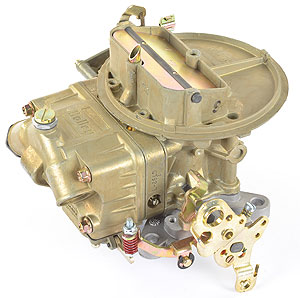

If you’re looking for a new carburetor, then a Holley two barrel will get the job done.  Here’s a picture of a Holley List #7448 that will bolt to the 2V intake in place of the current Autolite carb.  This one is 350 cfm.  You can figure on having to reroute the fuel line.

Morning all, former member here coming back to the fold! I won't bore you with the details but my '59 Galaxie has lain dormant for the last three years while real life got sorted out & I managed to keep her out of the hands of the lawyers. Now there is money to spend on her again...
My galaxie is a 292-motor with the 2100 2-barrel Autolite. The only deviation from stock is the fuel pump, which has been bypassed in favour of an electric pump. I am looking for a replacement carb, as mine is damaged beyond repair. Is some kind gent able to point me in the direction of a list or webpage that will show suitable replacements for this? I'm not after huge HP gains or massive performance upgrades, just a stock carb that will pull my old beast down the road again.
