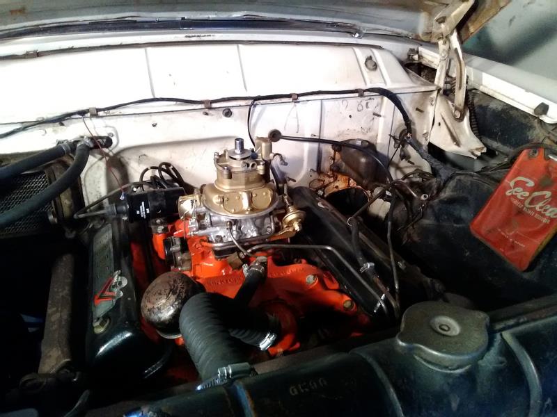

I don't know, I'm still running everything stock with the Holley 4000 teapot, I don't believe it has a TV cable.
http://forums.y-blocksforever.com/uploads/images/4dabc00e-3723-4b85-8dcc-e368.jpg
