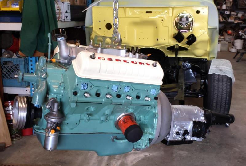

Just did the Gene Benson C4 conversion thang on my 292. Mummert supplies additional well detailed instructions with this kit - better instructions than Bensons. Parts all fit well and went together slicko. I just started a project photo thread in the "Street" section. Good luck with whatever you decide.
