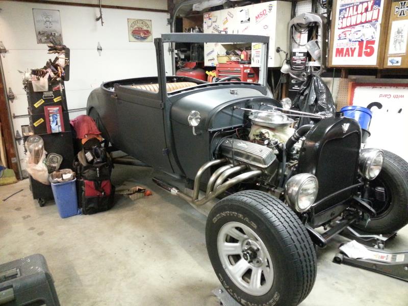

Still working on my '29 with a 292 installed.  I put a 390 FE fuel pump on and would like to know which port is inlet from the tank and outlet to the carb.  One pic I looked at had the inlet to the front fitting.  Is that correct?
Thanks in advance.

http://forums.y-blocksforever.com/uploads/images/404253f7-d11a-47bb-8dbe-4527.jpgShould have checked first.  The pic shows the two connections as level with each other.
http://forums.y-blocksforever.com/uploads/images/2bb5facb-88fd-4cd2-9deb-6c15.jpg
It’s hard to tell from the picture which is the inlet and which is the outlet.  Sometimes the pumps are labeled at the ports in the casting as to which is which.  If the hose side of your pump was already nippled, then you likely have it hooked up correctly.  If both the inlet and outlet sides were threaded, then check if one set of threads is NPT and the other is inverted flare.  The inverted flare side would go to the carburetor.  If it comes down to it, then the pump can be removed from the engine and the pump arm simply worked up and down by hand with fingers over the ports to determine which is the inlet and outlet.
