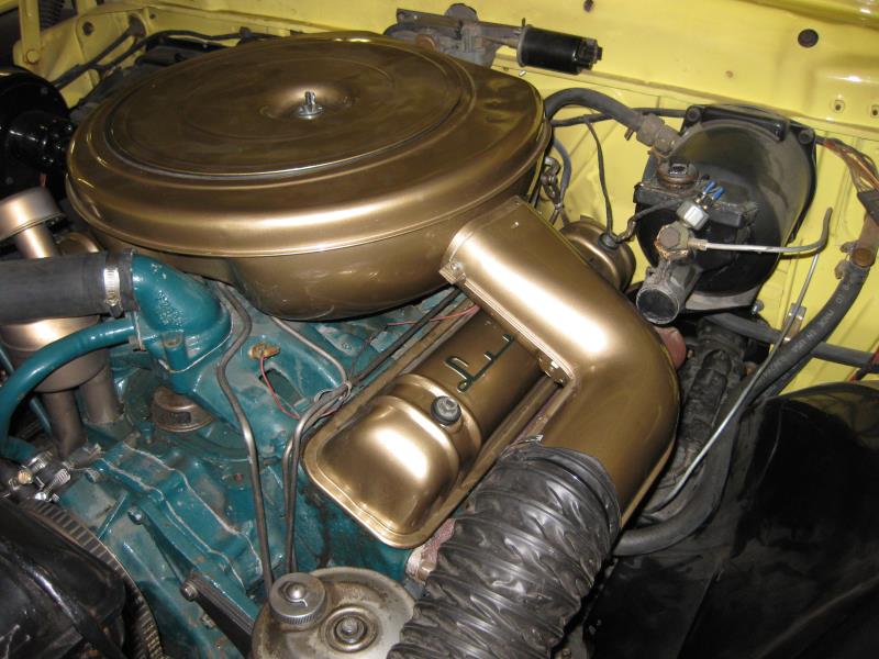

That's what's nice about having a 368.  The lifters drop in from the top.
http://forums.y-blocksforever.com/uploads/images/538f732a-99ed-4dcd-b3c1-620c.jpg
http://forums.y-blocksforever.com/uploads/images/1d5b145a-1c57-4c0d-8bd1-fba5.jpg
