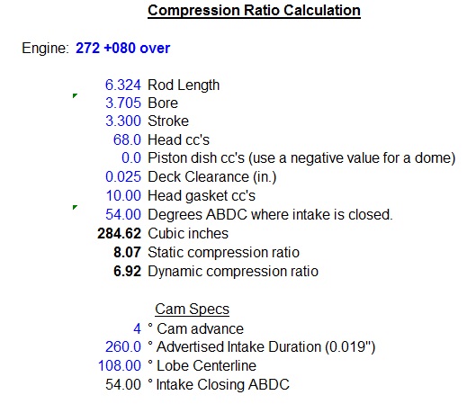

As has been brought up, there are some variables in calculating the compression ratio.  Charlie’s numbers are a best case ‘high’ scenario so depending upon the cylinder heads being used and where the pistons are sitting in the bore at TDC, the compression ratio could be much lower.
Here’s some numbers that can give you an idea where your compression ratio could potentially be but this assumes a composition head gasket, the pistons being 0.025” in the hole, and 68 cc cylinder heads.
http://forums.y-blocksforever.com/uploads/images/dc9980af-3563-4aef-8fa6-6b6c.jpg

The KB piston site has a calculation section. The one to determine comp ratio is excellent and I have used it many times for my Bonneville engine builds. The Dynamic ratio is always a little disheartening but true none the less. You do need to know all the specs Ted used in his explanation. Good luck.
