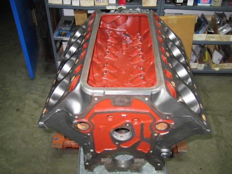

Any opinions on the use of Glyptal in my engine rebuild. Thanks

Its been a standard for increasing oil flow back for many years. Must work because its still widely used.

I have done it on several race engines and did it on my Y block rebuild.

Wow that is a lil more than I was looking for. Seems like people either love it or hate it . I think I will just de burr and clean up any flash thanks again everyone

All my GMC 6 racing engines are Glyptal inside. Always with GE. I worked in the power utility business for over 40 year on electric motors up to 13.8 KV and applied properly is a great product and never peeled or chiped off.
