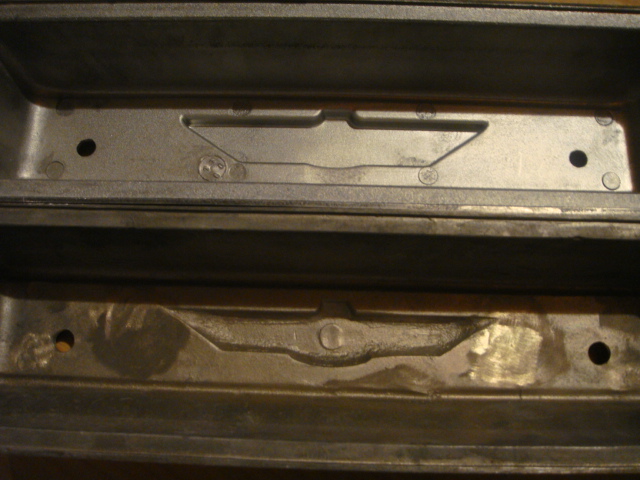

How can you tell if the aluminum thunderbird valve covers are real and not reproductions? Is there a casting number?

The underside of the Ford valve covers will have the impression of the Thunderbird cast deep into the top of the cover.  The reproductions do not have this indentation.  Joe-JDC

    Thanks guys for the information. I purchased the valve covers. They are the real deal. Now should I have them buffed or can I do it myself. Also do they clear coat them after there buffed.
