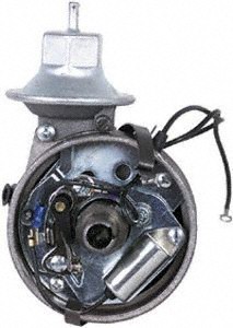

Ask for the replacement distributor for a "64 Ford pickup (F-100 or similar) with a 292 v8. I believe the Cardone number is 2808-01 or something like that at several suppliers. Expect to pay about $100 or near to that. It is a single point distributor with internal mechanical advance and a vacuum advance pot.

You can get an inexpensive carb adapter from Speedway in Lincoln, Nebraska to fit a later design carburetor onto the '56 4bbl manifold. The carb hole patterns don't match - and throttle bores need (smoothly) aligned - but the adapters do a fair job for a reasonable price. If you can acquire an 1957 - or later 4bbl manifold that would be a good find. The stud pattern will accommodate later carbs - but as Mike said above - the throttle bore openings are small and if you don't use a heat isolator spacer (or open them up) there will be an awful flow restriction step below the carb.
