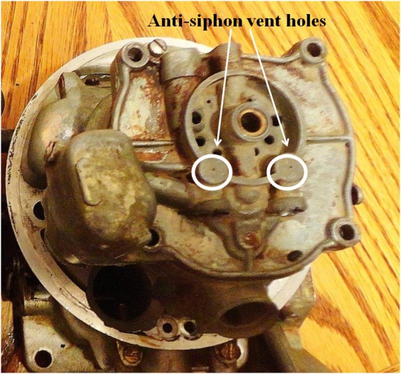

There are two vent holes in the top of the carb. Make they are not plugged. Pretty small. Use a small wire to clear them.

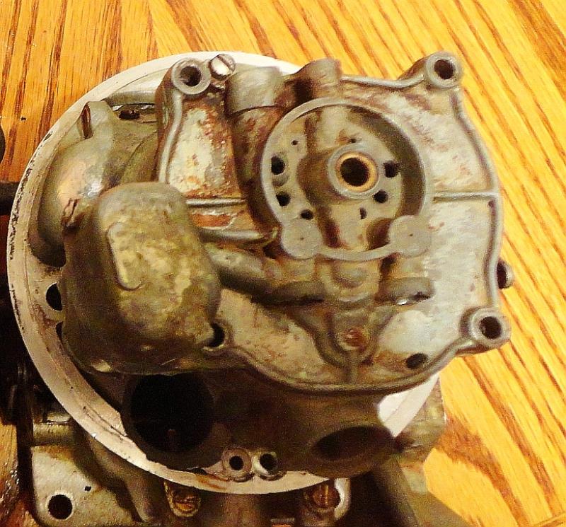

Will do, sorry for the bad quality, but here's a picture of the top of my carb, not sure if its any of the holes visible here.

I thought those were the ones you were talking about cool. Um those wholes are like incredibly small, any suggestions on what tools would work on those? Maybe a needle tip?
Posts: 1.4K,
Visits: 179.6K
IF you go to a welding supply, look for the self contained container of tip cleaner files used for an onyacetylene torch. Too, a farm supply store like Tractor Supply will have them, too. Sears used to carry them if you can find a store in your area. In using these 'files', be sure to go straight in and out of the hole... Hope this helps.
NoShortcuts a.k.a. Charlie Brown near Syracuse, New York
Posts: 108,
Visits: 5.8K
If you have any of those paper twist ties used on bread and other grocery things to close the bag just scrap off the paper. Inside is a fairly soft small diameter wire that is good to clear small holes. Since it is relatively soft it wont damage the hole - Bob
AKA Bob-93021
Posts: 3.0K,
Visits: 8.7K
I like to use a strand of copper wire. It's softer and less likely to damage the carb.
Frank/RebopBristol, In ( by Elkhart)
Last Active: 4 Months Ago
Posts: 1.2K,
Visits: 137.2K
I just pulled a wire off a wire brush.
