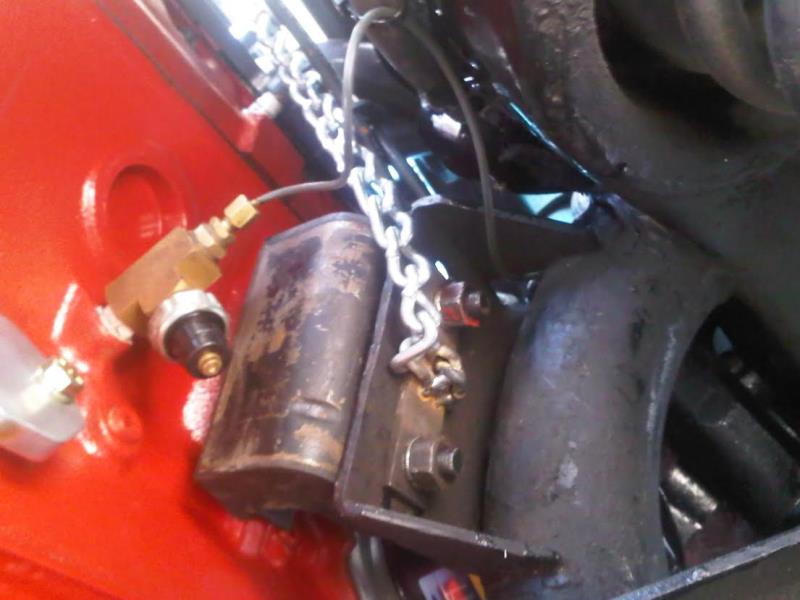

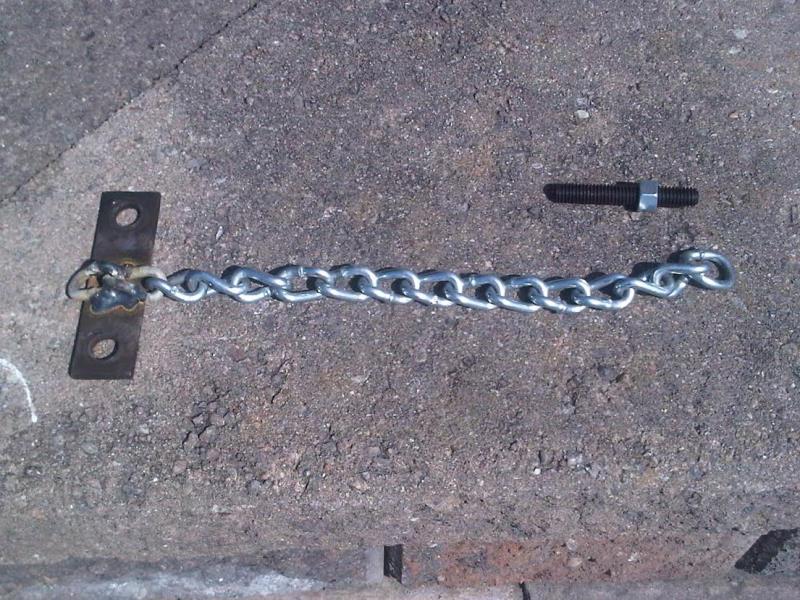

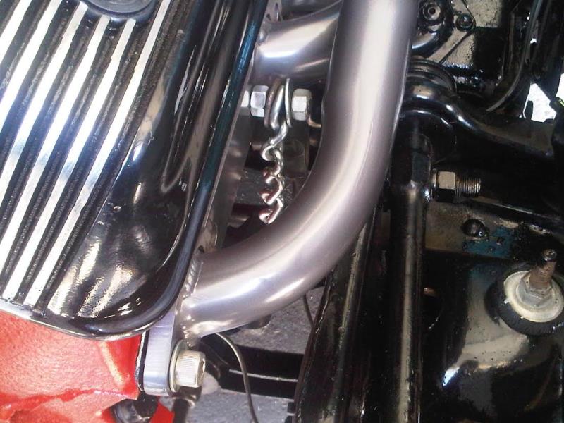

Bob Martin is preparing an article on motor mounts for Y-Bock Mag. A lot of the racing guys Like Vic, Frank, Wally drill and bolt their mounts. I haven't had any issues with my mounts (yet) but I didn't want to take a chance with the torque my new motor was putting out, so I made a chain set up to hopefully prevent my motor from rolling up on the mounts. http://forums.y-blocksforever.com/uploads/images/1c529afb-a1a2-4d8c-86b1-191e.jpghttp://forums.y-blocksforever.com/uploads/images/6e0c0e8b-e087-4609-b7ed-ae9b.jpghttp://forums.y-blocksforever.com/uploads/images/bc395a1c-b69b-4334-af88-21e6.jpg
