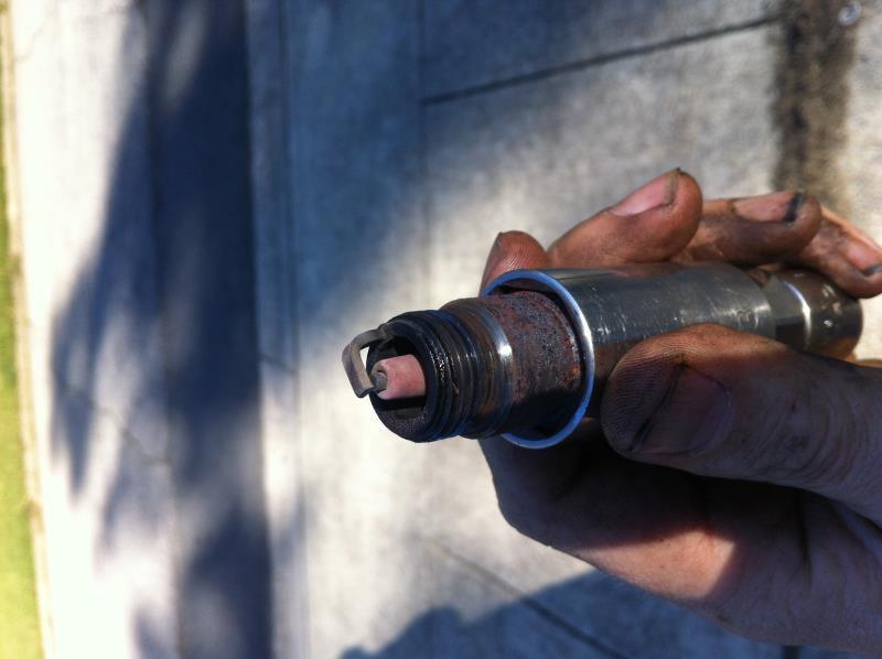

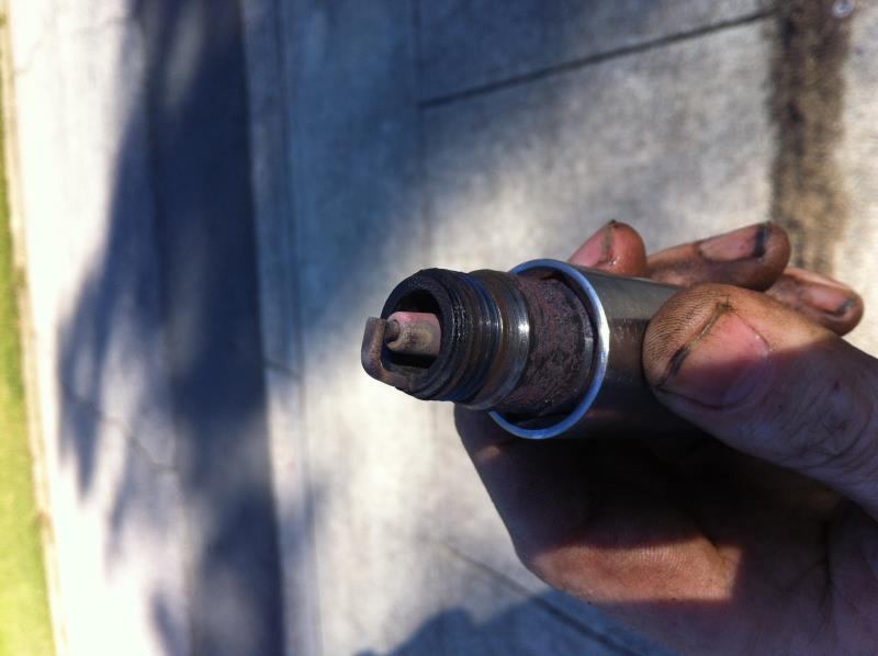

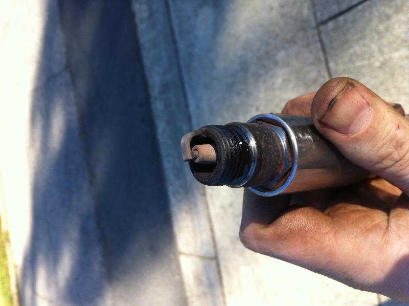

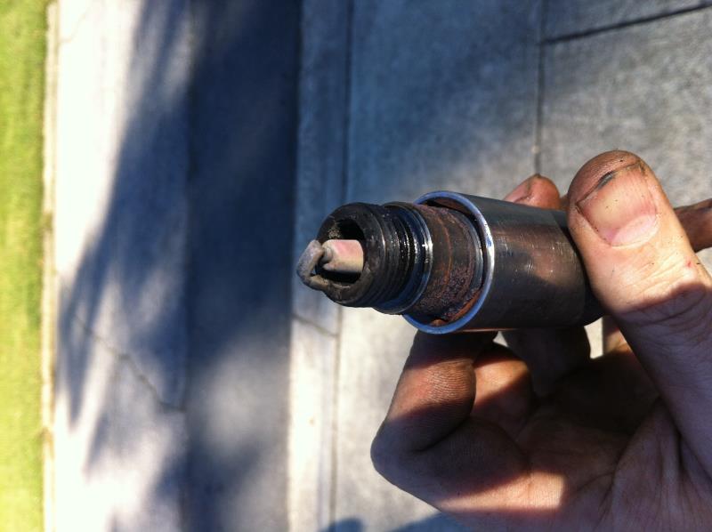

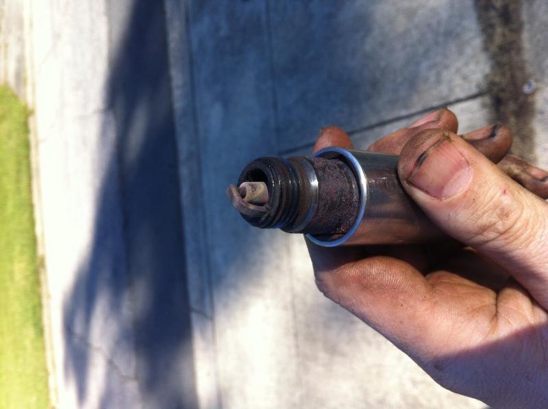

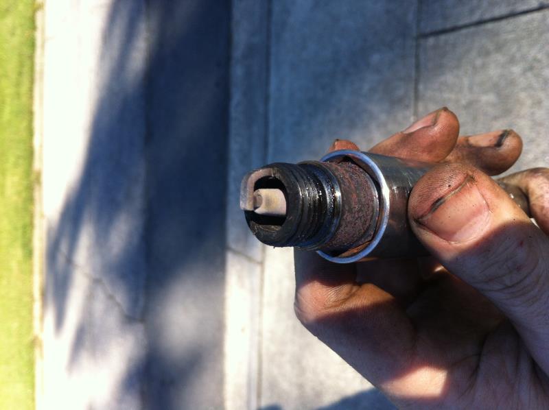

How do the plugs look?

Spark plugs: here are some pictures of 3 different plugs I pulled. Most show a pink residue which I'm told is from a fuel additive (I usually run shell regular). The first 3 are one plug at different angles, the next 2 are of a second plug, an the last 2 are a third.
