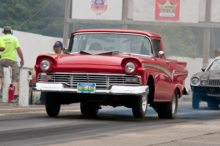

Thanks Sal  it should ship out to me next week.
57 Ranchero in action.jpg (478 views, 287.00 KB)
