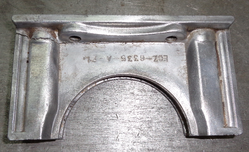

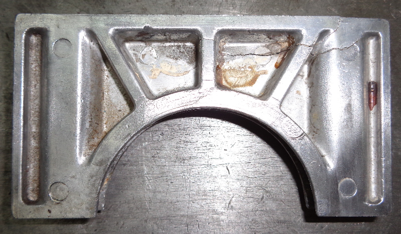

There are several areas at the back of the Y engine that can make an oil leak look like it’s a rear seal leaking when it’s actually something else.  The rope seal does put the rear seal itself high on the list as they can be tricky to get right even for the experienced engine builders.  Other areas to check would be the rear seal retainer side seals, the oil galley plugs, and the cam plug.  The rear seal retainer not sitting square on the block either from warpage or residing on a piece of the rope seal is also another thing to look at.  If it is indeed the rope seal, then replacing it with a neoprene seal would be my own recommendation.  Here are a couple of links covering the rear neolprene seal installation instructions and warped rear seal retainers.
http://www.eatonbalancing.com/blog/2008/09/10/neoprene-rear-seal-installation-for-the-y-and-others/
http://www.eatonbalancing.com/blog/2009/06/28/warped-rear-seal-retainer-on-a-y/
The rear seal retainer itself can be a problem if it’s warped or cracked.  Here’s are pictures  of a cracked retainer that came out of a 312 which had been daubed heavily with RTV in which to slow down the leak.
http://forums.y-blocksforever.com/uploads/images/b5685b9d-02b2-454f-80cd-c6c4.jpg
http://forums.y-blocksforever.com/uploads/images/be18cd9a-2214-49e0-8410-4560.jpg
