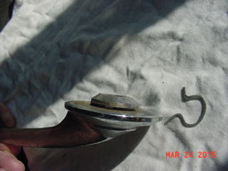

Here are a couple of pictures of the back side of the handle and the clip.  The Mac's tool shown by MplsMike looks like a good way.  I have a tool that operates like pliers with notches for the clip but the Mac tool looks easier.

Awesome!!  Thanks guys!!...I was using the wrong tool.  Your advice saved me lots of trial and error with the wrong tools/ideas.  I'm pretty sure the "M" tool is part of the small selection of stamped handle-removal tools I bought the other week.  I'll give it a shot as soon as I have a few minutes to try.
