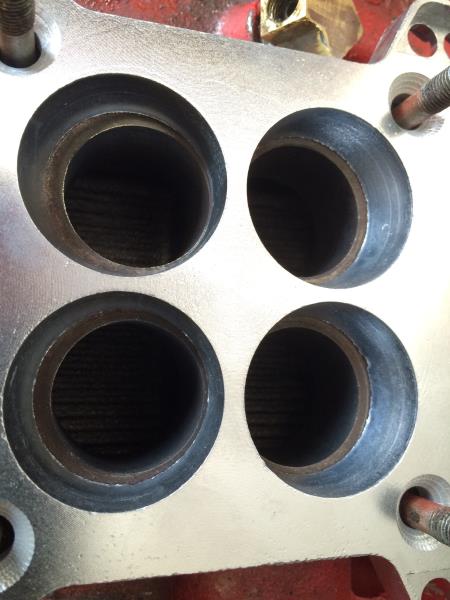

http://forums.y-blocksforever.com/uploads/images/cecf69eb-17e9-4580-a284-c322.jpg
 This is an ECB-B manifold with the 4 barrel spacer i purchased through Speedway. I have not run the car yet but I sure don't like interruption in flow. I think if I had to do it again I would hunt down an ECZ.......
1955 tbird
There are tapered adapters available, I think from Speedway.  You can also scribe the manifold and open it up to match the spacer.
