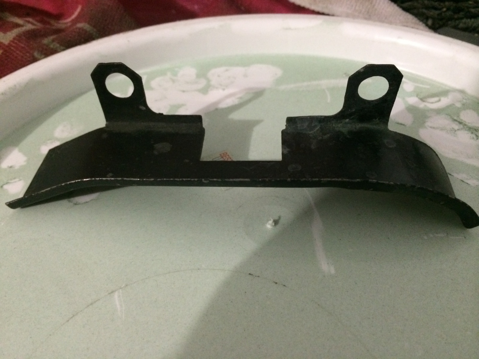

I pulled the 312 out two years ago and have just put it back in... but I don't know where this part goes, its thin and all metal. I have two identical pieces
Thanks for any help I get

There should be four of these, they go to the underside of your exhaust manifold to protect the sparkplugs from the heat, the manifold bolts hold them in place.

Thanks bloke... Sheesh... that means I only ever had two, because I remember taking them off now... do I really need to put them back where they belong ?
