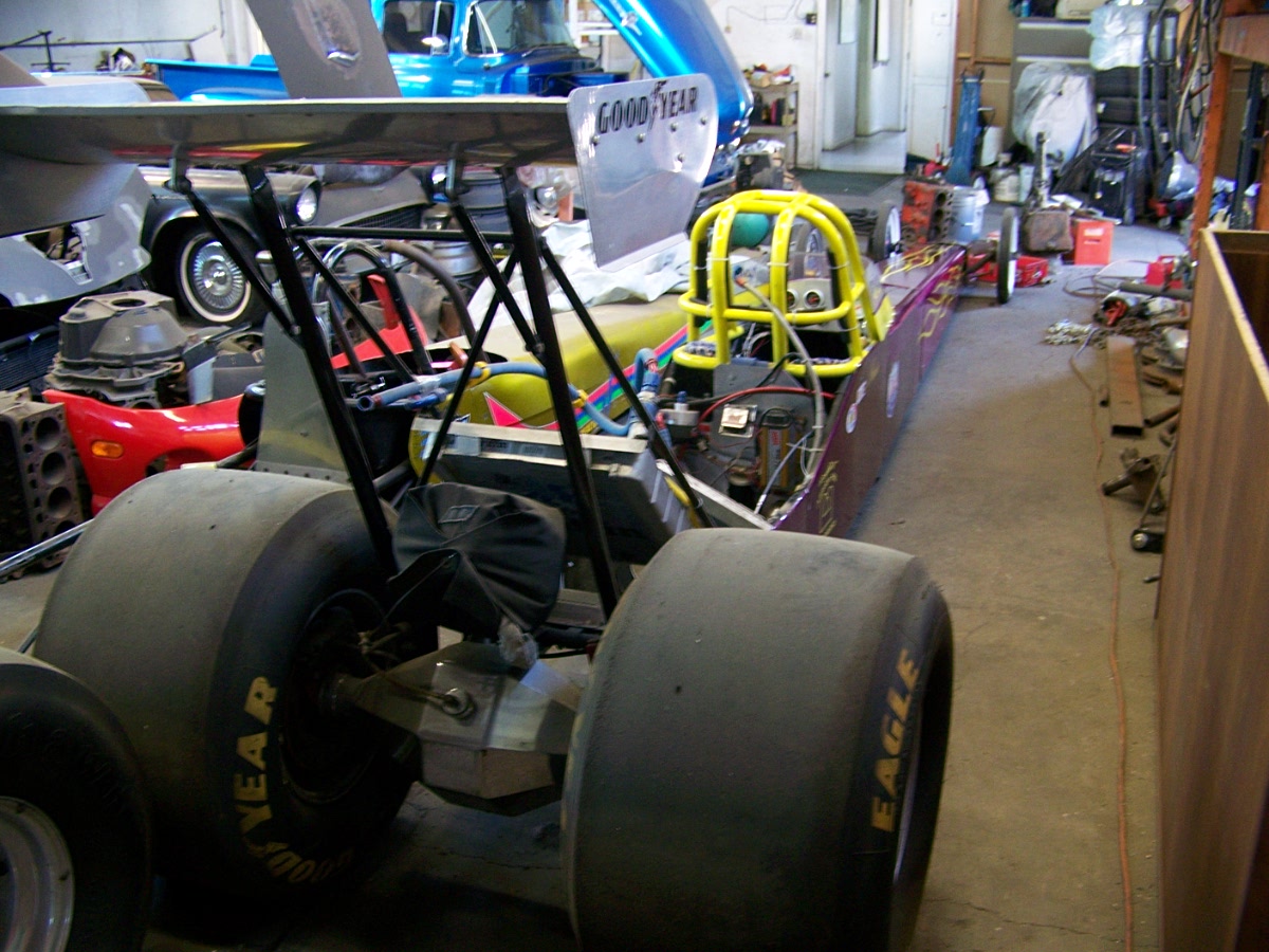

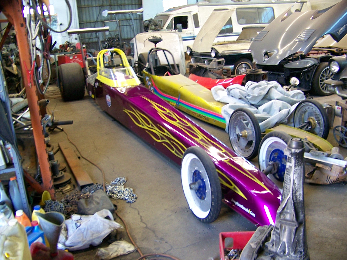

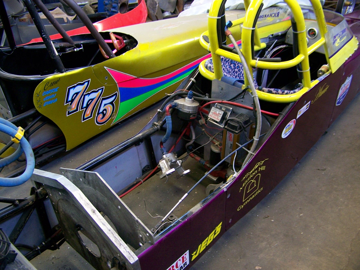

Hi, I putting together rear engine dragster (Spitzer), it is set up for a powerglide (motor plate), I would to keep the glide, what is the best way to adapt it to a Y Block Ford?
Thanks Cliff
