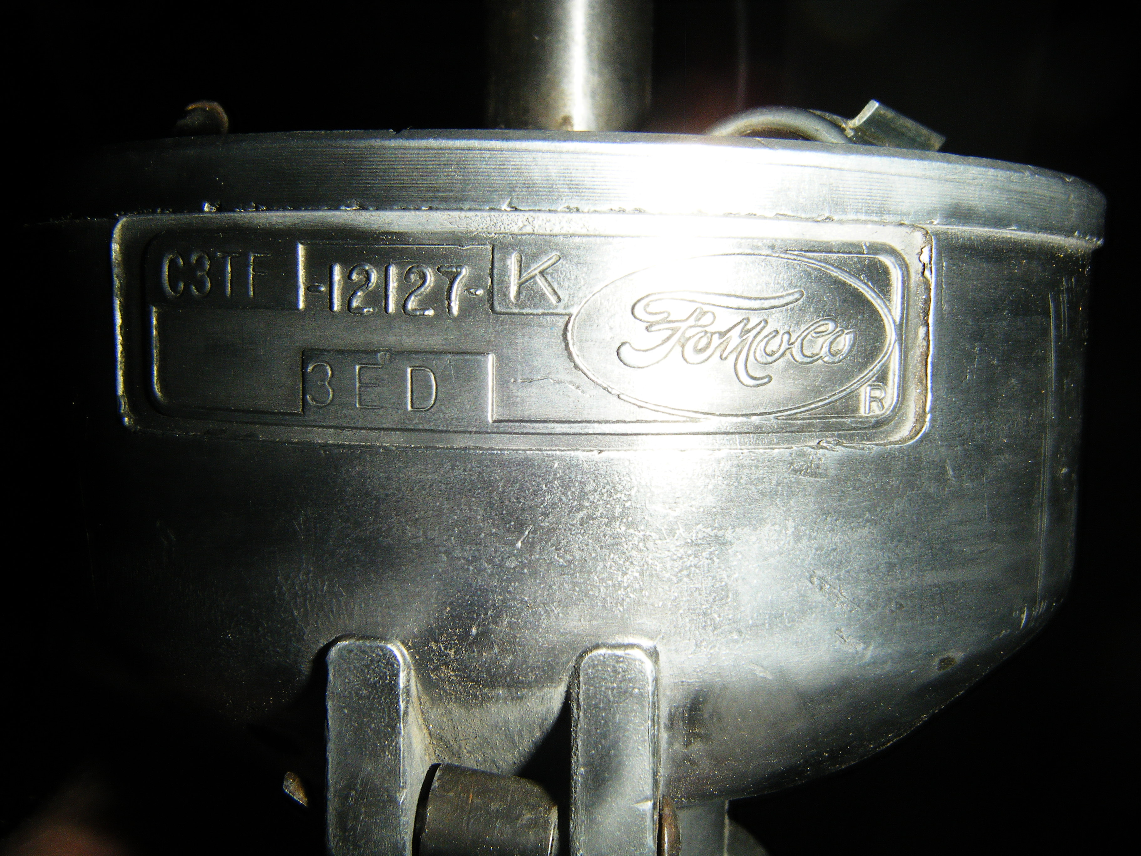

This is the distributer I believe came off a 1962 F-100 Unibody stock 292 with two barrell manifold and carb. I have an ECZ9425B intake so I can block off the road draft tube on my 1956 Stock 272. To move forward with the removal of the road draft tube, understand I must change the distributer if I want to have  more options for carb choices. The distributer is CT3F-12127-K. It has the ford script logo and 3ED below the first part number. Hoping I have everything right so far except the carberator and that the choices I have made have given me lots of options to find a good used carb I can rebuild.
