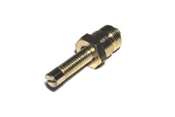

The first thing that comes to mind is the damper outer ring has shifted.The only way to check it is remove the rocker cover on passenger side and rotate engine until both valves are closed on #1 cylinder..Should put you very close to TDC.Check the postion on the damper.If its off you have found the problem.Many old timers used to set the timing with a vacuum gauge.If its not pinging or hard to start it should be fine.If it is,back the timing down until it doesn't.

Hi Mark. Yeah checked the damper with Piston TDC Stop similar to this one. The "0" is right on the money. Has me a little baffled.
http://forums.y-blocksforever.com/Uploads/Images/ebbbcabe-630c-40be-a973-e74f.jpg
By the way I'm probably one of those "old timers that used to set the timing with a vacuum gauge". We used to "Power Time" the engine also, haha
