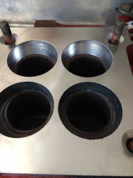

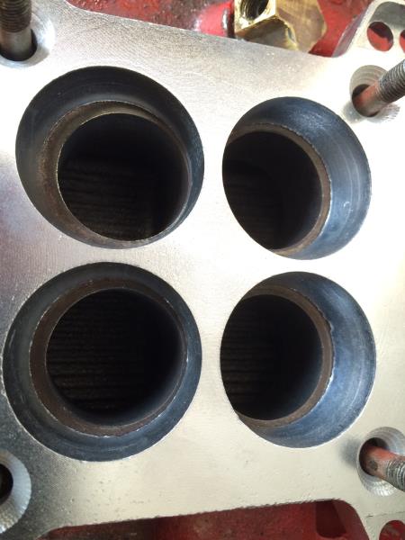

depends on which 4barrel manifold your teapot came off of... 1955? If its the ECB manifold than you might have trouble finding one that fits. I will post pics of how the Speedway 135-1935B adapter fits on an ECB manifold. The manifold ports are smaller than the adapter  and looks like it could cause a flow problem.
http://forums.y-blocksforever.com/uploads/images/879e847a-f0b8-4f5f-b896-f92d.jpg
http://forums.y-blocksforever.com/uploads/images/4d18481f-4c55-4310-885c-3c09.jpg

I have no idea how it lines up on an A manifold, The images i supplied are showing speedway adapter on an ECB manifold. Which one did you use for your B manifold?

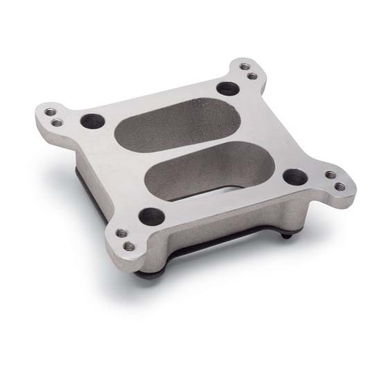

Here’s an adapter that’s listed for a flathead V8 and is by Edelbrock.  It’s on the pricey side being $70 but does provide some additional height.  Here’s the link.
http://www.speedwaymotors.com/Edelbrock-1106-Carburetor-Adapter-4-Barrel-Square-Bore-,108808.html
http://forums.y-blocksforever.com/uploads/images/e8acf7a0-7b51-4f37-ab86-f7ba.jpg

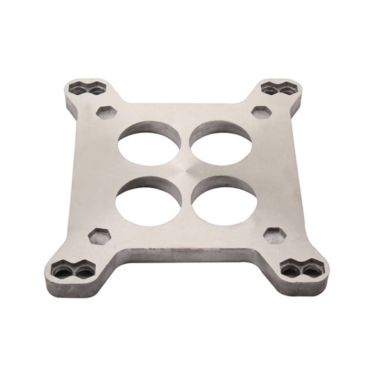

The following adapter is the one I have used several of on dual quad intake conversions and gets the job done at roughly $15 each.
http://www.speedwaymotors.com/Universal-Carb-Adapter-Tapered-Port,69.html
http://forums.y-blocksforever.com/uploads/images/f4cd3bc1-c4bb-4d80-99ab-8b0d.jpg

sorry to hijack thread but its relates to the OP's question. Ted, did the $15.00 speedway adapter fit similar to the pics I posted that show the size difference between the manifold ports and the adapter ports? I have yet to run the car with this adapter installed. Did you experience any flow issues? I can't help but think the restriction with sharp edges would cause some sort of performance issue? Thank You, Brett
