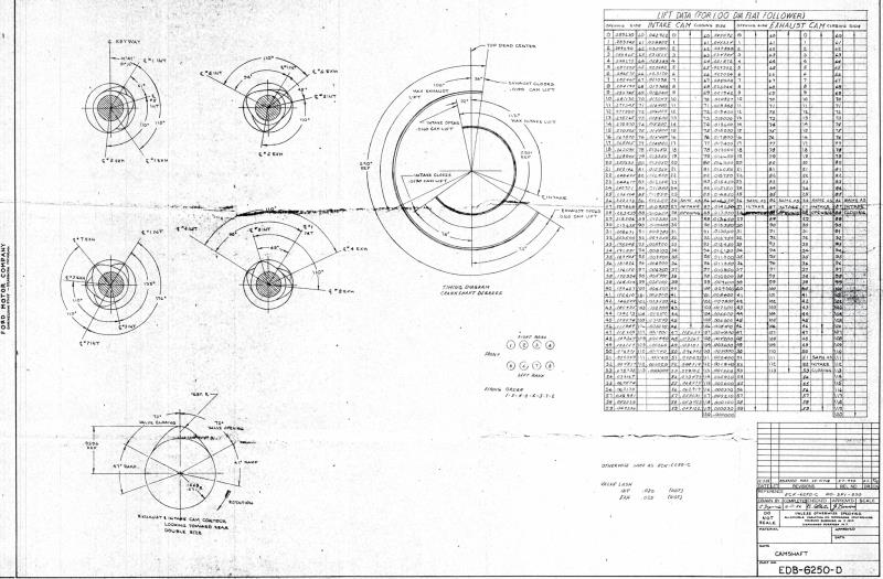

Isky can still grind the Ford 0.290” hi-lift EDB camshaft on brand new blanks.  I have been led to believe over the years that Isky was the original supplier to Ford for that particular camshaft and that it was originally designed for the dual quad 285 HP engines.  The 285HP engine program was discontinued with the introduction of the supercharger engine and based on the inter-office memos, the first 100 supercharger engines received the 285 HP hi-lift camshaft.  That first 100 supercharger engines were all used with standard shift equipped transmissions and were equipped so to be legal for the Daytona race that was coming up.  Later supercharger engines received the production ‘D’ and ‘E’ code camshafts as they were more driver friendly when coupled to the automatic transmissions.  In running the Isky hi-lift camshaft on period correct normally aspirated iron head engines on the dyno, it’s worth about 15 HP over the factory 1957 272 (B code), 292 (C code), & 312 4V (D code) and 312 8V (E code) camshafts.
Camshaft: Iskenderian 301-S-903, solid tappet cam, 1.000” lifter face
            Adv duration:             290°I / 290°E
            Lobe lift:                     0.290”I / 0.290”E
            Valve lift:                    0.415”I / 0.415E before valve adjustment w/1.43:1 rockers
            Valve lift:                    0.447”I/0.447”E before valve adjustment w/1.54:1 rockers
            Valve lift:                    0.464”I/0.464”E before valve adjustment w/1.6:1 rockers
            Lobe centers:               110°
            Duration @ 0.050”:    234°I / 234°E
            Valve lash:                  0.016” Int, 0.016" Exh, Hot
Here’s the original Ford blueprint for the EDB-D (Supercharger) camshaft showing a completion date of Aug 11, 1956.  This pretty much matches the Isky camshaft.
