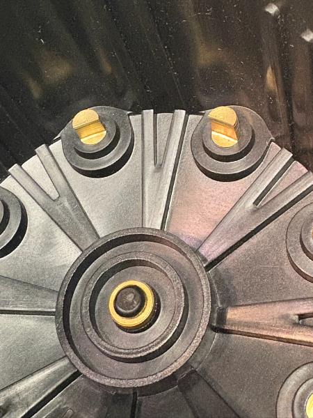

This is a picture of the first cap (I used white paint in the cavity so it would show up in the pic):

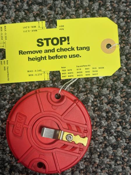

Have you checked to ensure that the metal tension strap on the rotor is high enough?  When installing the cap, you should feel the spring tension of the rotor strap before the cap is fully in place.  Ford Deaborn makes a good suggestion in measuring the height of the installed rotor versus the depth within the cap.
MSD has had an issue in the past with the spring tensioned strap on the rotor not being high enough to contact the center pole of the cap.  If there is an air gap present between the rotor and the cap, then erosion of the caps’ center contact can occur and even more so with some of the high output ignition systems.  The same issue can occur on MSD clone distributors.  When this is found, simply bend the strap so it’s higher.

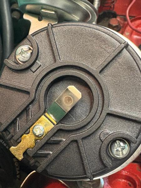

If anything I was thinking it might be too high.  You can see a witness mark on the rotor.http://forums.y-blocksforever.com/uploads/images/69dfea9e-fcf6-4829-9e72-49ea.jpg
This my 3rd cap that was on the car for maybe 200 miles with the TSP coil.  It looks like 50% of  the button is already gone    http://forums.y-blocksforever.com/uploads/images/01137663-e3a4-4611-bbfb-32a6.jpg

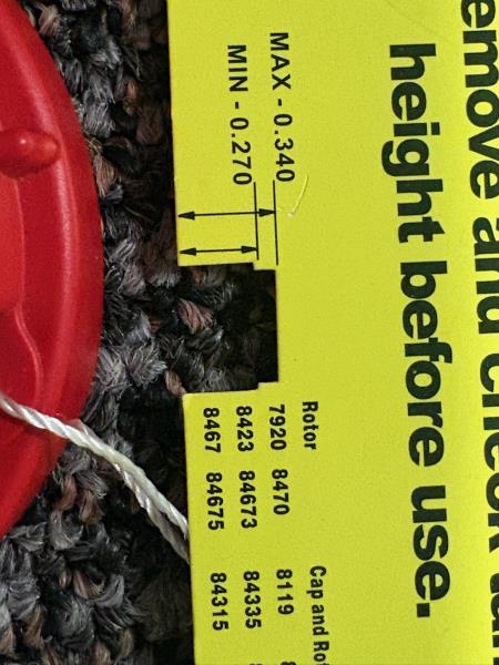

The MSD rotor arrived yesterday.  There is a tag attached to it to measure and adjust the tang.  I have never seen a spec for tang height, I never bought an MSD rotor before.
Part number for rotor 8467, cap 84333 (black) 8433 (red)

They are making an attempt to address the mismatched/anything goes ignition parts being sold these days - this is encouraging. Would you post a picture of the inside area of the cap showing the conductive posts and carbon brush?  MSD is cast on the top surface but years ago, the quality manufacturers used to  cast in their "hall mark."  Just curious if MSD has any marking as such in there....

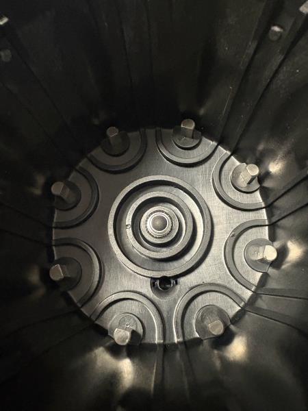

This is the CRT cap (with semi worn button):http://forums.y-blocksforever.com/uploads/images/a4155e38-4e32-4d3e-9760-9edd.jpg
This is the MSD cap (has a vent):http://forums.y-blocksforever.com/uploads/images/3858c84f-b7ef-4c45-8c33-c1b2.jpg

Thanks for the pics, there is no manufacturer's mark in the cap but that doesn't mean is won't be a good product. It does have an ozone vent and with the included instructions to insure the rotor spring is set right shows they are trying to get it right....we'll see.

The top of the cap is embossed (like the rotor) "MSD"

I installed the rotor as described on the measurement card.   I noticed the contact on the rotor bends more easily than the CRT, so I assume it puts a lot less pressure on the cap/button.   The cap/button is also spring loaded NOT fixed like the CRT.   The light metal contact and spring loaded button seem to have fixed the issue....................

MSD sells a separate HEI Low Resistance carbon rotor button (part no. 8412) that claims to reduce excessive heat buildup that can melt the distributor cap. does the 84335/84336 cap have the low-resistance button? The button can be installed in an MSD cap that has a spring-loaded button, but the cost is $25-$28.
No clearance issues.  I just had to change the spark plug wire ends to female.
  I don't know if it has the high temp bushing, I can't tell if it's removable
