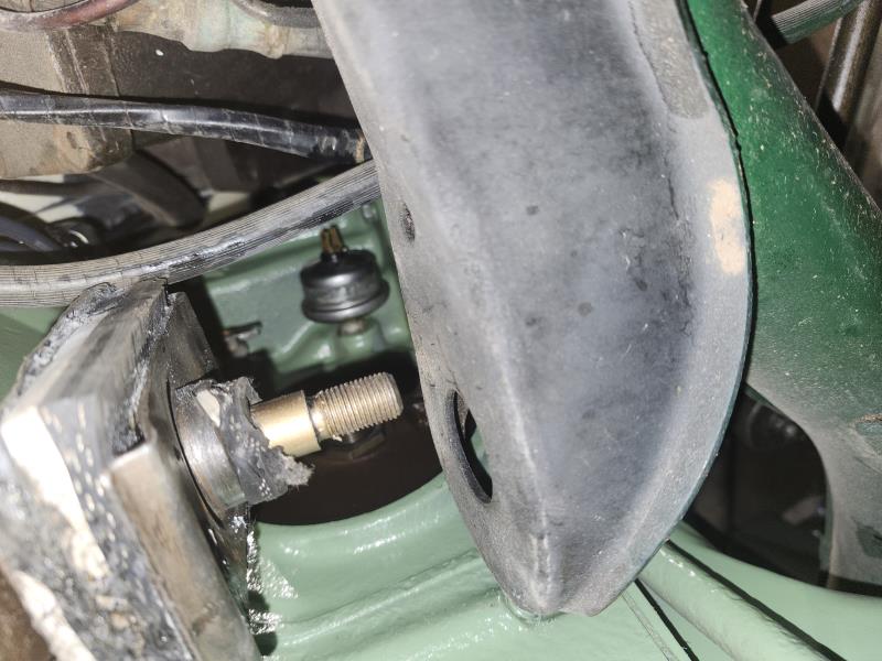

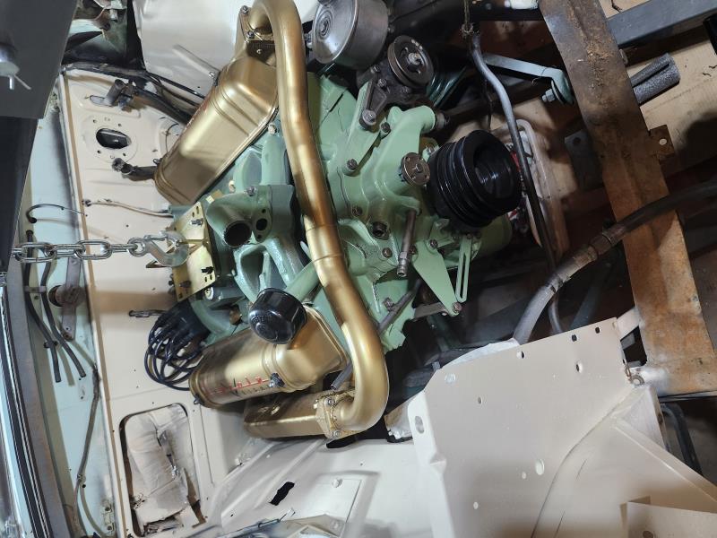

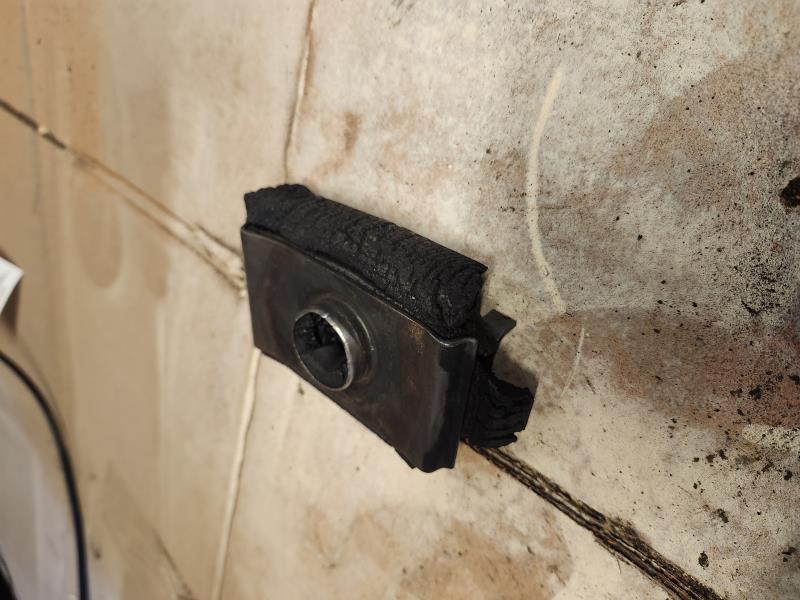

I got my 317 in the engjne bay with motor mount bolts over the holes in the frame piece. But the passenger side needsvto go right a bit but that'll push the driver side bolt too far from the hole.
Are the motor mounts the same or are they side specific? It wont be too difficult to switch them out but its like 95 in the shop these days.
First pic is passenger side mount and 2nd on is driver side. Both taken from front of car. The rubber will look strange as i had to make them myself.

I made the upper rectangular rubber pieces, the lower conical shape ones are good. Both bolts need to go toward the center of the car so they both wont line up. That's why I was asking if they are the same. The pictures you posted are not the same rubber parts as mine. AI said they are side specific with different part numbefs, so I'm going to switch them just to see. Theres no reason they won't line up otherwise

The bottom of 6038 has the protrusion i speak of. In this picture. It fits in a hile of similar size in the frame mount area.
Do how do I move them an inch or so so they fit in the hole in the frame? I'll try to loosen them up and try to fit the protrusion into the hole and tighten to the block. I might try to put something behind the top of the mount, above the bolts to try to bring the mount bolts inward so the holes line up.

Finally installed!!!!! What a pain in the butt getting the oil filter housing back on. Worked on it for almost half hour and still didn't get it. Tricks????
