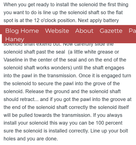

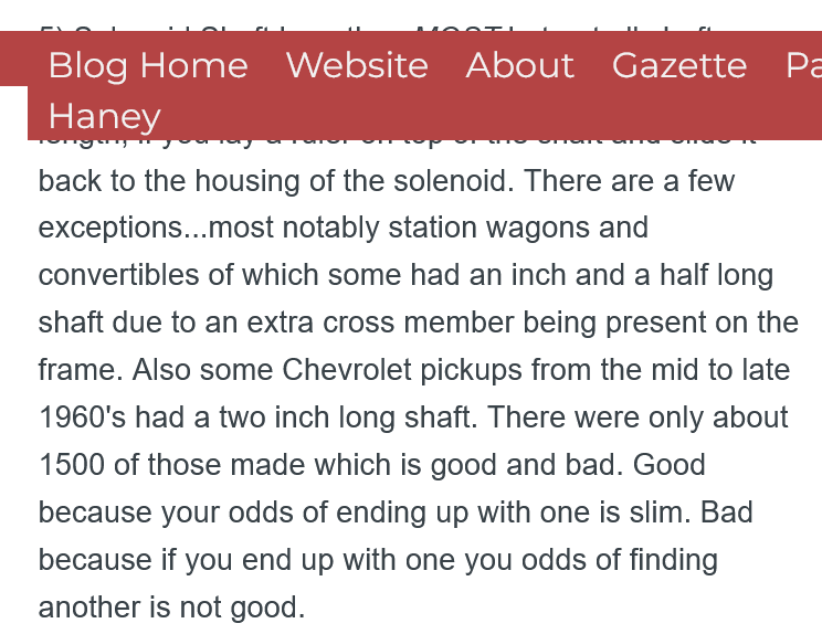

By KULTULZ - 2 Months Ago
By DANIEL TINDER - 2 Months Ago
Some solenoids that test ok on the bench, don’t work well on the car.  I believe many NOS parts that thus proved defective were merely returned to stock, rather than the manufacturer. I once built a special jig to bench test them, applying resistance to the shaft.
http://forums.y-blocksforever.com/uploads/images/1c3666d3-9c20-44d0-8de0-dfa1.png
http://forums.y-blocksforever.com/uploads/images/4e47c18a-6720-4d8b-ab4e-c00d.png
