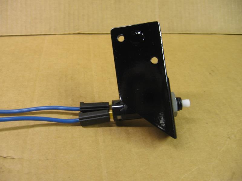

I made a bracket for a mechanical brake switch on my 54 Ford.  Works great.  I did a write up on it and took pictures.  If interested, send me your email address and I will send it to you.

http://forums.y-blocksforever.com/uploads/images/748b8267-4b50-4147-b826-b1de.jpgHere's the bracket andhttp://forums.y-blocksforever.com/uploads/images/aa669ac0-8106-486c-9bd6-801a.jpg switch I made for my 54
By Bobwanna - 9 Years Ago
Very clean install! Looks OEM. Definitely on my list to do on my 55. Thanks - Bob
