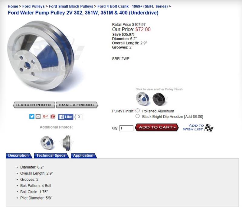

Hey Greenbird, what was the diameter of the pulley you used? There seems to be several different variations.

jdwilker. Greenbirds smaller pulley idea saved my 59 Vic's over heat problem at idle and traffic. The one I bought was 6" OD and chrome from a speed shop near me. I rubbed it with a scotch bight and painted it semi gloss black. Ted E said there were many different sizes for different parts of the country. Mine was 7-1/4". Good luck
By jdwilker - 10 Years Ago
Thanks for the info. My original pulley is 7.25" and has a depth of 2.5". I've seen several FOMOCO pulleys that are in the range of 6" in diameter but with different depths. I did find one pulley that is 6" by 2.5", but it's a double groove. I'm thinking that won't matter?

I got the aluminum pulley from CVF and had a friend machine off the back groove to shorten it. Pretty close to the exact required location for the Thunderbird.
http://forums.y-blocksforever.com/uploads/images/39e5c89b-8719-4de7-8f92-9955.jpg
You can also use a steel double groove from a 302 - and cut it off short as well. Looks like the price has gone up on the aluminum version.
http://forums.y-blocksforever.com/uploads/images/243521ef-0fc1-4333-945d-13fa.jpg
As the others have said - I really prefer the mechanical drive fans - and when I fitted the Hayden clutch, slippage cut the available speed by a fair amount. Plus - when I got the waterpump speed up a bit, you could actually see water rushing back into the upper radiator tank (which is what my 289 motor ordinarily did) when the thermostat was full open. Be sure to use one of the wide opening thermostats.
