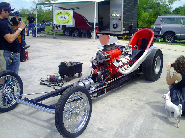

By aussiebill - 16 Years Ago
mctim64 (9/7/2010)
Took the head off Elwood yesterday and found I have a cracked block! :-( Oh well that's racing, guess I will run the engine I had planed for my truck to make the Oct. 9th Eagle Field meet.
Maybe sleeving to 4" wasn't the best idea, ran great though. Wink  Does Mr. Eaton have an idea how to avoid this if I do another block, the internals are still good I kinda hate to waste them.
Tim, i.m curious what effect did that crack have with the block being filled? i,m assuming the headgasket firerings bite down hard to seal, could you just fill that crack with metal filler and dress flat? i have had 4"er here for years on stand, not run yet but your problem has me concerned. As you know theres not much deck integrity left when doing 4" bore.Cool

By mctim64 - 16 Years Ago
Well I've been talking about building a dragster for some time now and have been gathering parts for a month, so now that I've actually got some work done on it I thought I'd share some pix of the process with you guys.  I want to thank Charlie Burns for all the help he has given me acquiring parts for the car and I want to say thank you to Ted Eaton for his help with advise and sending me his Y/Powerglide adaptor template, although I've decided to go with a C-4 since the Eagle Field rules now say "no two speed transmissions" but we didn't know that when he sent it.  I'll be getting that back to you soon Ted. Smile The C-4 bell I got from John Mummert, a very nice item indeed. Smile
Anyway here is a look at what's going on and there will be more to come.  The work is proceeding nicely now and I hope to have a running car for the May 22nd meet, well we'll see. BigGrin

And here are a couple more photos of last nights progress.  I also got my axel from Mark Williams yesterday. BigGrin

Split the engine and trans yeasterday, here's what I found.
Thinking of going with 7/16" studs and a "Beefier" spacer to prevent this from happening again.
blah bla bl b
By mctim64 - 13 Years Ago
The car is back together and ready to run.  Here's what we did to fix it, replaced the studs with 7/16" bolts and welded spacers made of 1" round stock dirrect to the converter.  I think it will hold up just fine.

Well the verdict is in, Rookie mistake.  I should have checked the valve lash, one intake adjusted itself tight and was open when it should have been closed.  Shame on me. Blush
By mctim64 - 14 Years Ago
Saturday I dedicated to changing out the 338ci Y that will go into my Model A Tudor for the 350ci Y that I hope will take Elwood into the "9s".
I tried to post this yesterday but the site was messed up on my end.
It's more than just a "swap out" as I have to change heads to use the front to back cooling and I also have to change the timing cover and I have a nice new oil pan with a windage tray and scraper.
While swaping these parts over I found something that makes a guy rather upset. I had a cam lobe failing. This is especially bad beacause I did everything correct on the break-in including light springs in the heads. The one lobe is down only .030 and it probably would have worked for a few passes but I know it wasn't going to get any better. So I had another cam that I had ground for the dragster engine anyway (the one that is shown was ment for Jake and LSR) so I changed it out. Even with the engine out it's no small job to change the cam and lifters in a Y but it will be worth it.
I'm also going for a gear change so I need to do it be for the engine/trans goes back in. I hope to get it all buttoned up today. Happy Easter!

OK! I work/played all afternoon and got the car ready to go back together. Most all the parts are on the engine and the trans is coupled back up. I didn't take a picture of them together though.
I did have a new pan made to work with the marine timing cover, the marine pan was big and "clunky" the new one has a windage try and a scraper. Also it looks quite nice.
I also changed the gears to 4.11s from 4.33s, it always seemed to be out of breath by the end of the quarter. We'll see how it is now.

Ok Guys, I got Elwood back together this weekend.  I'm going to be running my 338ci spare pickup engine so I can make the Eagle Field meet, it will also be a nice test of the engine as I may use it in the next project as a C motor in the new Unibody LSR truck.  The 322ci 4" bore dragster engine will be back and running as soon as I get my solid copper gaskets back, they should isolate the cooling liquid to the heads and make the cracks in the block a non issue.

This should be the cure for the 322ci with the 4" bore. I will still be running the 338ci Y this weekend but the intended motor will go back in soon.
I'm looking into some solid copper head gaskets with holes for the studs and cylinders only, the block is filled and the heads are the only thing that water flows so I may just bolt them on and go.
Alky?  Maybe later, it's a gas class that I run it in right now but who knows what the future holds. Wink

charliemccraney (9/7/2010)
What do you think is the cause? Too much heat, or that the structural integrity of the block was compromised when sleeving?
If you need more cooling, can you use copper head gaskets to help transfer more of the heat from the top of the cylinders?
I'm sure the "integrity" was compromised in the sleeving and the heat is a factor, the Moroso block filler I used is supposed to expand at the same rate as the iron and weigh the same as water but that may or may not be the case.  Either way this motor is not completely dead yet. Smile

We made it to the races yesterday and what a madhouse. In Oct there was about a quarter of the people that were there yesterday and I don't think the volunteer staff was prepaired for the croud. But in the midst of all the confussion we managed to have a good time and get three passes in with "Elwood". With Bigredtodd's '60 F-100 (Earl) as my official tow vehical we went through tech without any issuse and pulled up to the line for our first solo pass. With the flaggers signal I eased down on the go peddel and was off. (this was my first time out so I didn't want to hit it hard) Everything went well till I hit second and a big cloud of smoke came off the right side of the engine. At first I was worried that something bad had happened but apon inspection I had just popped the dipstick and shot some oil on the header. So we come around for a second run. This time I'm more confident and ease up to the line, the flagger signals me, I run the engine up to about 3000 aginst the brakes (the drums held wonderfully), the flag went up and my foot went down! This is the best expirience of of my life, well my wedding night was pretty good too, Elwood took off like a gun tracked perfectly strait and I went through three gears without a hitch. I've got a smile on my face that can not be removed now and we come around for a third pass. This time I'm thinking I'm a pro so I pull to the line, run the engine up, the flag drops and I'm off. Passed the finish line one of the airscoops flies off and at that instant I get a face full of oil. The engine is still running OK as I shut down to be towed back so I don't think I hurt anything.
After thinking about it for a while I think what I did wrong was in my engine build. As you all know I like to pressureize the rockers, well somewhere around 7000 rpm I think that there was just too much oil returning to the valley by the filler neck and my one and only breather. The pressure in the crankcase just blew the oil up towards the filter on the end and out it went. In the "Yellow Brick" engine we have restricters to the rockers, it sliped my mind for my own engine. Well I will be cleaning the car today and thinking about restricters in the feed to the rockers and better crankcase breathing.
The car runs and drives great, I'm sure My Mom is looking down with a smile on her face.

Was an awesome day...being a tow rig was great, enjoyed meeting new folks, and helping represent the fridge factor:
Also to be considered one of your crew at the event...with my sought-after hose clamp skillsTongue (L to R Charlie, Todd, Rick, Tim, Curly, Moe, and Larry):
Even though my day ended like this when I lunched the Caddy in Earl on the way homeSick...should be noted that the McMaster Y-block powered rigs made it to their destinations without similar issues...
Aouple other pictures as well...the "pit" area:
And a picture I like from the end of the day...

Kathy bringing me my reward for a hard days work.
mctim64 (5/5/2010)
Well guys I finished the car last night and here it is! w00t
Just how many "rewards" did you have before you saw the cartoon animals??Wink
In all seriousness (if I'm capable of that) the car looks awesome!

Interesting shot of the block. Is it an optical illusion or are there sleeves in all of the cylinders? I noticed the rear block plate. With the C4/Yblock bell housing there is already a need for spacers between the flywheel and converter. The block plate may make them very long as well as the crank hub spacer. I like the use of a C4. I run one in my 1931 Model A Coupe with a Cleveland motor. My friend Dana Sniff (949-559-6563) and I have worked up a super trick trans for my Coupe. Dana lives in Irvine, CA. and is one of the best for this trans. He makes and mods many parts for the racing C4. The converter I use is from Andre at EDGE racing converters in Simi Valley. My Coupe ran 9.58 @ 137 at Famoso last Fall. John and Geoff Mummert and I are working in a Yblock for the Coupe and hope to run it at the March Meet in Bakerfield this year. We are also putting on the first annual "West Coast Yblock Shootout" at Barona drag strip on the May 4-5 weekend. Hope you can make it down.

Tim:
My swap meet 427 block I bought for my '63 R code galaxie had some sleeves in it, and cracks across the deck as yours does.  Got water in the cylinders.  I'm sure you are aware of wet sleeves for farm equipment.  I got some used sleeves free from a John Deere with  a usable bore size, and machined them to fit the holes in the block, but I left the flanges on the tops of the sleeves and turned them down to an appropriate size.  Then I counterbored the block for one hole, put in the sleeve, then counterbored the other one and put in that sleeve.  That makes the flanges interlock and completely cover the deck area between the sleeves.  The flanges are big enough on the OD that the gasket seals any water that tries to get through.  It's a street engine, but it works for me.
By Hoosier Hurricane - 16 Years Ago
Tim:
That head gasket on the lower right shows failure on the front cylinder exactly like what I found on my engine.  What puzzles me is that my heads have a post in that spot, still it fails.  I've started on another block for replacement.
Maybe you can remove the sleeves, and install some bracing between the cylinders, under the deck. Screw them in place, and mill them flush. If there's room, cross bolt them from the outside of the block and inside the valley. From there, you maybe able to make some braces into the valley which tie the under the deck braces together between the two sides, further increasing the rigidness of the block.

Tim.  As Glen mentions, the cam tunnel in my own 4” bore block took a serious twist as a majority of the block support was removed when installing the sleeves.  For the time being, that particular rotating assembly along with a different set of pistons was moved into a 3.859” bore block and is running extremely well as a 375 incher.  My own 4” bore project has been relegated to the back of the project list.
The cracks between the cylinders appears to be an ongoing problem when going to a 4.00” bore with sleeves.  Furnace brazing the cylinders in place would probably help but that’s something that’s just not available in my part of the country.  I did try a hefty layer of epoxy resin under the deck to help strengthen this area on the big bore EMC engine but still had some issues with the deck flexing.  Didn’t blow a head gasket but water seepage into the cylinders at the edges of the sleeves was an issue.  But I was still running coolant in the block and my water issues were at the deck where the non-circular head gasket leaves the edge of the sleeve.  In my case I was using ½” head bolts and hard to say if that helped or hurt the situation.  No easy fix from my end.
