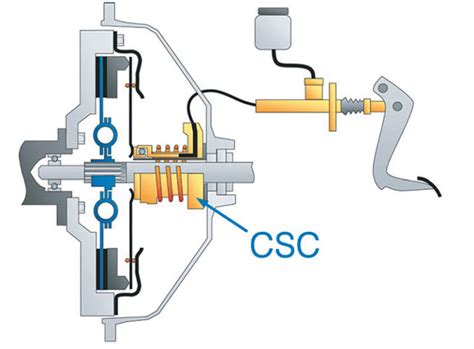

By KULTULZ - 6 Months Ago
" ... stock clutch fork/throw-out assembly would successfully operate a concentric clutch.  I’m now having doubts, as it appears an aftermarket hydraulic rig may be required (?).  I may thus just change the discs in the OEM unit (already have  them)."
They make such a kit for your BIRD?
Is it a complete kit (MASTER and BEARING ASSY) or just the bearing assembly?

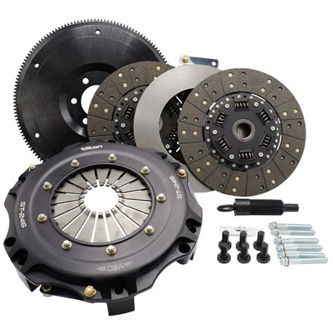

By Litshoot - 6 Months Ago
Daniel what do you mean by concentric clutch. looking it up im getting hydraulic release bearing or dual disc clutch. are you referring to the pressure plate with diaphragm springs? for diaphragm pressure plate mechanical linkage is fine as long as you have flat faced bearing that contacts correctly and have proper air gap. If go hydraulic make sure you have enough travel to release fully and a pedal stop to prevent overtravel.
CLICK HERE - https://www.youtube.com/watch?v=vHO1Led3RZc
You bought a complete CLUTCH SET with dual clutch disc CONCENTRIC SLAVE CYLINDER actuated (CSC)?
On your kit (if kit), how is the CSC actuated? Usually, these are for FWD. Is the assembly meant for a RWD car?
"I may thus just change the discs in the OEM unit (already have  them)."
You posted discs.
Modern clutch assemblies are offered with SINGLE or DOUBLE CLUTCH DISC.
I am just trying to help you here.
If you do not want to exchange with me, that's fine There is an IGNORE FEATURE here (I believe).
You're OK ...
The CSC is the actual throw-out bearing. It is just activated (extends) by internal hydraulic pressure instead of a hydraulic slave cylinder and/or a mechanical clutch fork.
I was just curious to see if kit makers were making available kits for older applications.
