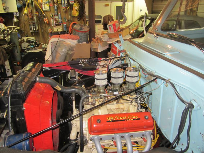

By KULTULZ - Last Year
Just a note -
The 4V INTAKE MANIFOLD for the 1957/64 272/292 TRUCK was slightly different than the PASS CAR ECZ-B.
I have never seen one (or realized it when I saw/worked on one).
I would think the difference(s) would be for the governors and related.

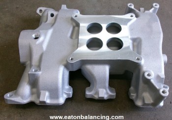

"Would you be able to modify my manifold?  My 292 is stock, are there any other porting mods for the manifold?"
Well, yes and no. Yes, the 57/ ECZ-B can be modified for a later style carb (larger throttle bore size). No, if wanting to mount a later style carb on your present intake as it would require an adapter and could not be used on a BIRD due to hood closing (carb mounting being too high).

By Ted - Last Year
RossL (8/12/2025)
While the actual slotting of the holes can be performed by the do it yourselfer, machining the flange flat does require some form of milling operation.  Due to shipping costs, it’s always worthwhile looking for a local machine shop that can do this operation as shipping costs can easily outweigh the actual machining operation.  But yes, if the manifold is shipped to me, I can do that slotting operation to it.  Just email me directly regarding doing that.

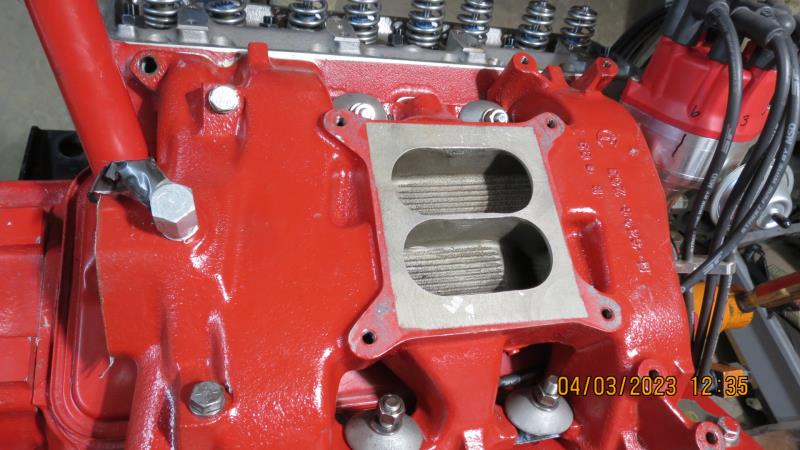

When I modify the ECZ-B intakes so that they are dual slotted, I typically do that so that the larger bore carburetors fit without ledges or flow restrictions at the entry point of the manifold.  If using a carburetor spacer, then the sizing of the holes within the carb spacer are taken into consideration.  For most of these modifications, I use a Moroso P/N 64930 four hole spacer as the template for hole placement and general sizing.  As Kultulz brings up, the ’55-’57 Thunderbirds are not carb spacer height friendly so take that into consideration.
In machining the Mercury 8 Restorations (M8R) aluminum 4V intake manifold entry bores from the as supplied 1.510” to the 1.783” size, there was an 8 HP increase.  Very significant increase and without making the entry slotted.  That manifold was tested in both bore size configurations with the aforementioned Moroso 1” 4 hole spacer but had a ledge or flow restriction at the carburetor flange with the 1.510” throttle bores.  The increase to 1.783” simply had the throttle bores in the intake manifold matching the carb spacer which was then topped off with a 750 cfm Holley also with 1.783” carb bores.  Here’s a picture of the M8R intake before enlarging the throttle bores.

Thank you for the education.  I will see if I can find a local shop to mill it, shipping costs are pretty high the past few years.  Do tell them just to make the surface "flat"?
Could I use this insulator as a template to open the holes?http://forums.y-blocksforever.com/uploads/images/dac74bd1-5861-45cd-b3b6-d0a8.jpg

Keep the slots straight at the divider.  Joe-JDChttp://forums.y-blocksforever.com/uploads/images/d41365a2-6415-4360-944d-0ecb.jpg
