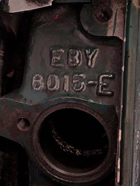

Judging from the pictures, the engine looks like a 256 not a 239.
By Hoosier Hurricane - Last Year
Changing to a centrifugal advance distributor, whether '57 and up Ford or aftermarket, will require changing the oil pump to hex drive and using the hex drive shaft.  Worth the effort in my opinion.
By KULTULZ - Last Year
That is a 256CI 4V particular to 1954 MERC -

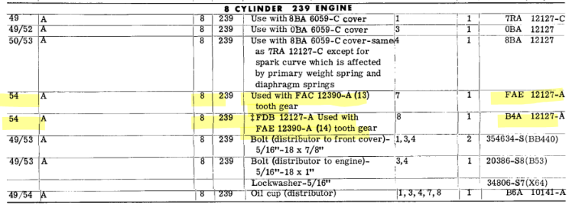

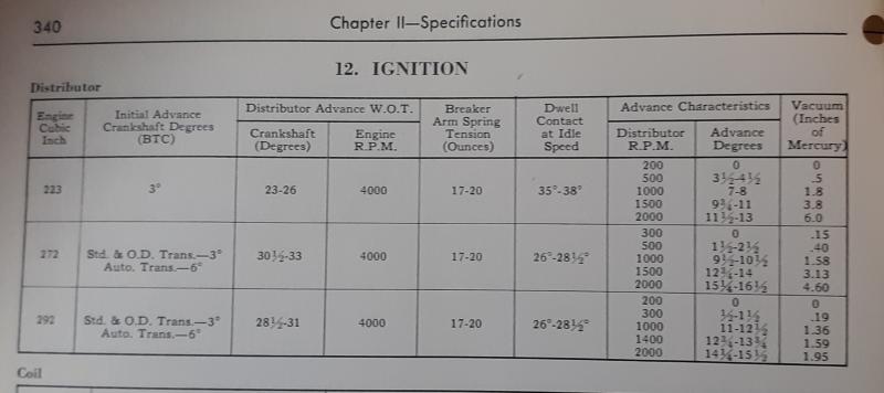

Here is a pic from my manual
That chart gives you how the DIST ADVANCE as was curved by the factory.
You can find the exact curve in your 54 MERC WSM under IGN - SPECIFICATIONS using the DIST ID NO.
It will be tough without the DIST MACH and manometer (LOM).
CLICK HERE - http://m571.com/yblock/loadomatic.htm
GOOD LUCK WITH HER ...

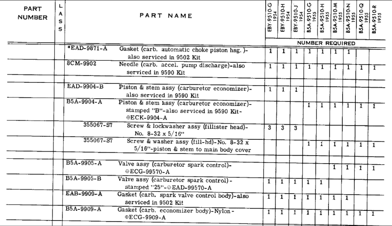

KULTUZ and DEARBORN first I attach the curve chart. The check valve is another eye opener!
If I am correct based on the article my check valve should be marked with a 6 or a 7, correct?
However, I'm a bit confused because in my picture the Mercury parts book lists it with PN. B5A-9905-B but mentions ' stamped 25' unless this is for a Ford PN?
The 'STAMPED 25' merely ID's the SPARK CONTROL VALVE if say you have an assortment out of the parts box. There is only one listed for your application.

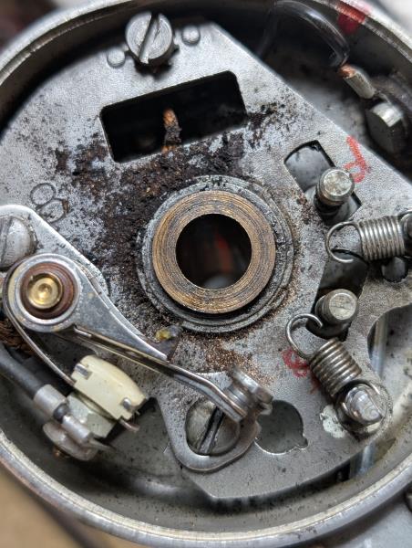

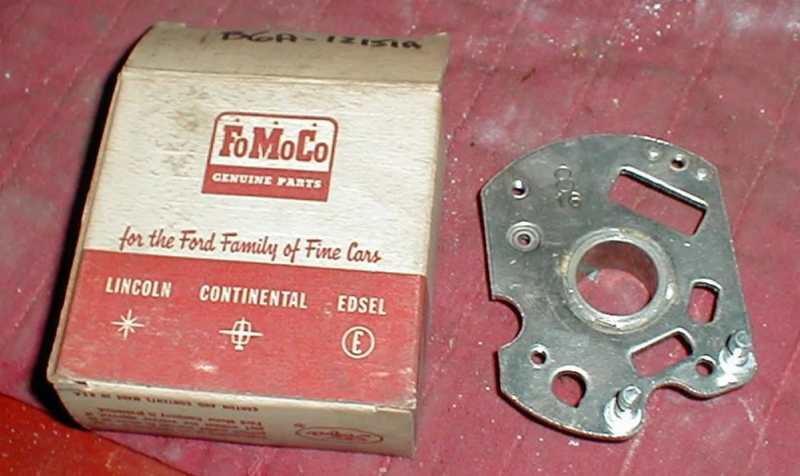

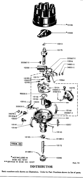

I think what is meant by 'shimming' is the addition/removal of shims in the DIST ADV CANISTER to control the vacuum advance. This was used on later DUAL ADVANCE. I believe this is what is being discussed.
You will notice on the BREAKER PLATE (12151) POST (12357) that hold the advance springs that they can be adjusted by rotating them (to adjust spring tension).
http://forums.y-blocksforever.com/uploads/images/3c26b72f-b523-4294-9fc7-371c.jpg
You will have to have a very sensitive vacuum gauge to measure correctly the small signal given by the carb.
What are the DIST ASSY ID NOS on all of your distributors? You may have a NOS that is calibrated correctly already.
http://forums.y-blocksforever.com/uploads/images/ec8dc0a7-d828-4ada-8c4d-a18e.jpg

The photo with "shim?" with arrow is not where shims are installed, if anywhere. That "collar" is to be tightly held in place with a roll pin. The collar should be pinned to allow a minimum of .020" up and down thrust of the shaft. My 1955 book calls for .020 to .024" thrust. The correct position of the gear is also a critical dimension that must be followed.         Trying to precisely  adjust the advance springs while in the engine will be challenging. Standard vacuum gauges are not accurate enough to split an inch of vacuum/mercury into a fraction but  by experimentation you may get the  "feel" of it.  The vacuum advance canister will need to be disconnected from the carburetor and then plumbed to the pump and gauge because with no load on the engine, the air flow through the carb will not provide a good and proper signal. There are devices available that can be plumbed in for precisely measuring small vacuum signals. If you would like to see the one I have, I'll gladly try sending a pic of it.    As stated above, the NOS distributor you have may be calibrated well enough out of the box.  You could push a vacuum hose against the canister connection and with the other end clinched in your teeth, make sure everything moves freely.

  My bad on the comment about the shims as that was a memory hiccup on my part.  I was originally referring to shims in the vacuum can and not the end play for the lower gear.  0.022-0.030” is the 1957 specification for the distributor end play so it should be similar for the earlier model distributors.
The dual diaphragm L-O-M distributors and the 1957 and up distributor vacuum pots did have some adjustability at the vacuum chambers by using different shims, springs, and spacers.  Looking through my stash of early single diaphragm L-O-M distributors, they all have non-adjustable vacuum pots.

It finally dawned on me 'shimming' was meant to located the driven gear correctly on the shaft.

'The photo with "shim?" with arrow is not where shims are installed, if anywhere. That "collar" is to be tightly held in place with a roll pin. The collar should be pinned to allow a minimum of .020" up and down thrust of the shaft. My 1955 book calls for .020 to .024" thrust. The correct position of the gear is also a critical dimension that must be followed.'
There is your answer for the correct driven gear placement.
If one has a DIST that needs the driven gear relocated, the normal practice is (was) to locate the collar/gear and re-drill the shaft ninety degrees off and insert new pins.

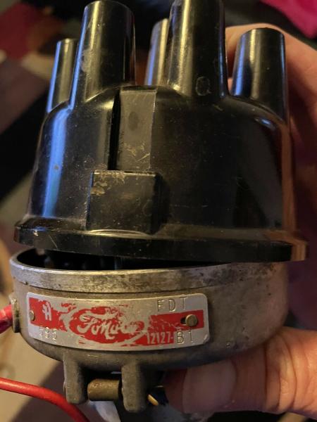

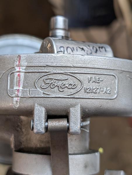

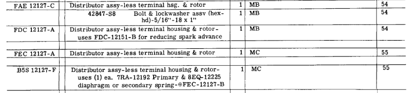

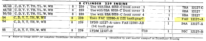

Aris, does the new NOS distributor and the new gear you have ordered have the 13 tooth count? Not 14 teeth.

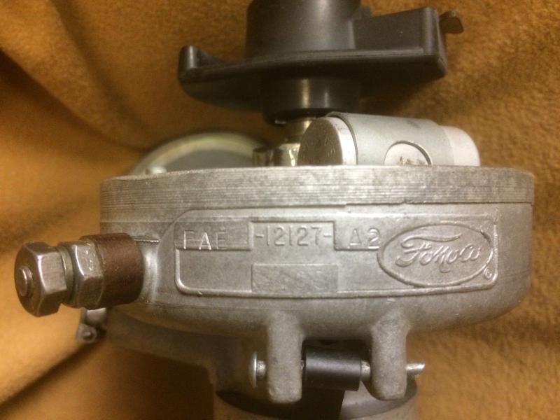

I just had a revelation - Exclamation Mark
If you bought DIST ASSY PN FAE 12127-A, it was released for the 1954 PASS CAR and LT 239CI (EBU), and will have a different timing curve than the 1954 MERC 256CI engine.
FYI - PN FAE 12127-A2 would have been the service replacement PN for the FAE 12127-A DIST.

I examined the timing and found that even though at idle, 500, and 1.000 RPM the advance was very near the chart's values, at high RPM like 2.000 instead of 15 degrees, it shot totally out of range like over 30!!!
Does that prove that the springs are not properly tuned? I'm not sure as I tested it without disconnecting the vacuum line and I wonder if that makes a difference.
So patience is the key, the NOS LOM is on the way, due here in approximately 25 days, I can't wait.

The primary spring is very loose and the secondary seems ok, however they are very different from each other.
I will try splicing a vacuum gauge in the line and test it running, based the timing chart and report my findings.

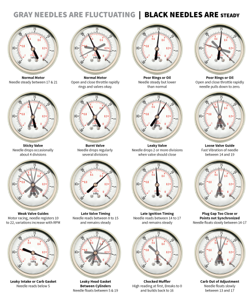

I would think either IGN misfire or a vacuum leak.
Don't worry about DIST signal now. The vacuum gauge has to be connected to A INTAKE MANIFOLD VACUUM source to read the engine. You also should take a FUEL PRESSURE and VOLUME TEST with the same gauge.

The valve I probably did not name properly is the one my original Hollley 2140. I read that it is the one that should open I believe between 6 or 7 whatever units the vacuum is measured with, to provide vacuum to the LOM distributor.
"The valve I probably did not name properly is the one my original Hollley 2140. I read that it is the one that should open I believe between 6 or 7 whatever units the vacuum is measured with, to provide vacuum to the LOM distributor"
http://forums.y-blocksforever.com/uploads/images/2051e381-0224-4250-939b-f55c.png
BASIC PART NO. 9905
In 1995, the BASIC PN (9905) went to BPN 9B572 in MERC CATALOGING so that PN (B5A 9905-B) may have been upgraded and hard to find.

Hi all! I have spent this time receiving parts and working on the project of making the LOM work like it used to.
Today I took the distributor out and as you can see on the picture first thing I see is brass shavings where the bottom side of the rotor was brushing on the top part of the shaft bushing.
I don't remember adding grease or oil there except in the oiler tube but that one lubes the shaft itself, not the top of it's bushing.
I'm at a loos as to why, I have to recheck my manual for the proper position of the shaft gear, because I replaced it and maybe I didn't do it right, but then again I don't know where that shaft should be actually ''sitting''
Or maybe I should have added a dab of Grease up there? I'm not sure.
By Aris - Last Year
Ok, I measured the gear position on the shaft and it is shorter than what the spec is, so it was my daft previous assembly that did the damage... Back on repositioning now....
At least you found the answer ... Wink
Is the bushing OK do you think?

I thought I was doing well until on the NOS plate I checked the eccentric posts with a tool I made myself and one of them was frozen stuck and broke off 😝.... BTW that plate did not look NOS to me...
I'll go for the best one of the other two plates I have, but I still have to remove and reassemble the gear before I start the engine and go from there.
I was also very lucky to find two new Spark Check Valves from Mac's carburetors, as before I get on to adjusting the springs I want to make sure I have the correct spark plug vacuum values before attacking the springs.
No reason to try and turn the post(s)s (most likely frozen) as it is a fine tune that requires the correct DIST MACHINE setup.

Post the DIST ID STAMPING NO from the bowl and I will give you the intended application -
Ok here are the three distributors.
1. FAE 12127-C H342 On the car recently
2. FAE 12127-A2 The one I had spare. No aluminum label, number is raised on the bowl
3. FAE 12127-A H461 The 'NOS' I bought now that came with 13 teeth, frozen pivot and wrong vacuum diaphragm*
*Note I tested it but it held no vacuum, took it apart and found a small 0.10 hole on the diaphragm, I can only guess it was not from a car with a ported, but another one with manifold vacuum
http://www.coolcarsimport.fr/decodeur-de-vin-mercury-50-57/
KULTULZ and ALANFREEMAN you got it right! I have a 256 ci as confirmed after the engine casted number has now appeared next to the distributor!

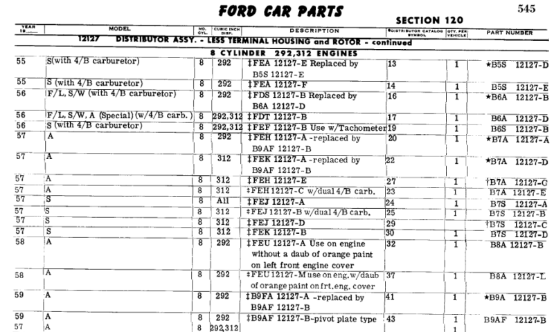

OK, it seems the ID PLATE (on some early FYB's and STAMPING NOS on some later LOM are actually SERVICE PN's.
http://forums.y-blocksforever.com/uploads/images/e75cae57-38af-47b9-b84c-6922.jpg
http://forums.y-blocksforever.com/uploads/images/de990578-0e56-4ead-8a97-3b45.jpg
- 1954-1955 MERCURY -
http://forums.y-blocksforever.com/uploads/images/44b9e46c-60a6-4d91-9f95-8014.png
http://forums.y-blocksforever.com/uploads/images/9d448566-ed9a-47a4-ab09-ed57.png
http://forums.y-blocksforever.com/uploads/images/635fdd59-8f47-43dc-abdb-db08.png
http://forums.y-blocksforever.com/uploads/images/2a592acf-7e25-4048-ae3e-72c3.png
The only use of dueling points (back in the day) was a longer dwell and a higher degree of coil saturation (especially with a period ignition amplifier).
With today's' TECH, there is little reason (IMO) for them.

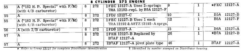

- 1948-1956 TRUCK MPC -
http://forums.y-blocksforever.com/uploads/images/4690be2e-481e-47a1-b218-149e.png
So the NOS FAE 12127-A you have is for a light truck application and the advance curve will most likely be very lazy.
You can find the exact distributor calibrations in each model year WORKSHOP MANUAL.

BTW I'm wondering if my mechanical DIY ignorance got me to this point: could the whole misfiring issue have started not from the LOM 'peculiar' tuning but from an EXPANDED shaft lobe, that was heating up because of the constant rubbing on the brass bearing? Just a thought, because I have put on 30,000 miles and I don't remember when the misfiring problems started. And of course back then I did not read (or understand?) my manual's clear instructions on having a 0.020'' gap under the lobe ...
Here is the pic of the one I had on that was misfiring. Again I have no recollection of how long it had been operational on the car to relate it to when the misfiring started. Memory was always one of my weak points but now at late 70s it is much worse....
... could the whole misfiring issue have started not from the LOM 'peculiar' tuning but from an EXPANDED shaft lobe, that was heating up because of the constant rubbing on the brass bearing?
Yes. If the bushing is worn, it will allow the DIST SHAFT to wallow and the points opening and dwell will be affected.
[B[ EDIT[/B] - If the shaft is not in correct alignment (defective bushing) it may also cause excessive wear of the actual cam (and points set rubbing block) also, especially if not lubed correctly during service.
There is an oil cup in older DIST that allows the bushing to be lubed at service intervals.
Can you wiggle the shaft and notice unusual excessive side to side movement within the bushing?

Actually, it is an IDENTIFYING TAG but just in another format.
HOLLEY was the vendor for FORD IGN and FUEL for that period. It may be the tagged ones were issued at the CLEVELAND PLANT and the bowl ID was issued at the DEARBORN PLANT.
The DIST tagged FAE-12127-C is the correct DIST for your engine (CLEVELAND ENGINE - CF).
FAE-12127-A is a DIST (13T) for the DEARBORN plant (DIF) and was issued for the light and medium truck 239CI.
Usually, when a PN SUFFIX ( -A in this instance) had a numerical character after it ( -A2 in this instance), it was an indication of an upgraded/improved replacement PN. FAE-12127-A2 is not cataloged so it may have been described in a SERVICE LETTER of that period.
Regardless, hold onto the original DIST as it will increase the value of the car.

There were two 1954 FYB engine series -
- the DEARBORN built 239CI which was the EBU BIG CAM ENGINE and had the 13T cam drive.
- the CLEVELAND built 239-256CI which were the SMALL CAM ENGINE(s) (EBV and EBY respectfully) and required     the 14T cam drive.

Ted yes, for timing I use a timing light and yes the mark moves when I rev it
If you see the timing mark advance with the timing light, the advance should be good.
If you put a vacuum signal on the vacuum advance canister (with a hand held vacuum pump or mouth suction), does the breaker plate advance and return (after releasing vacuum) easily and does the vacuum canister hold vacuum?
If that low of mileage, the DIST advance may be hanging but not totally dysfunctional.

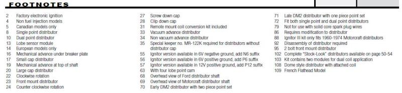

While PERTRONIX does offer an IGNITOR for the 6V NEG GRD LOM DIST, I have read casual references to the OD electric control interfering with it's operation (I believe the momentary electric supply cut-out) confusing the IGN MODULE?
Do you have any other info/experience?
BTW - The FDT-12127-B1 DIST ASSY the OP showed earlier was a 1956 FORD 292-312. I would think that one would have better advance curves if he kept LOM..
