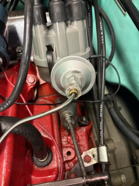

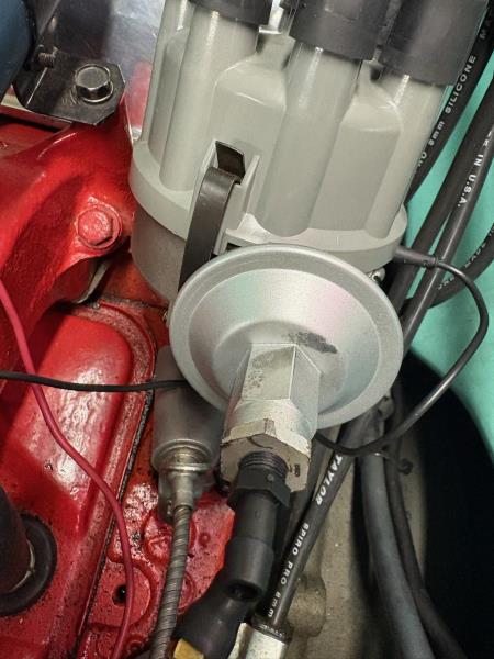

I installed the 57 Dist in my car.  I don't have the vacuum advance connected, because I haven't modified the carb yet. Do I need a fitting in order to connect the vacuum hard line line into the distributor?   I have a fuel filter fitting screwed in now, but I don't want to use this long term.

The fitting and a vacuum line are available from the TBird part suppliers. It is a compression type fitting

By KULTULZ - 6 Months Ago
If you decide to keep the H2140/H4000 (modified DIST signal) the made-up line and fittings shown @ CASCO will not fit as it is for a LOM DIST.
I think you are going to be happier (and richer) with the modified H2140 and 1957 DUAL ADVANCE DIST once you get the CARB signal worked out. Maybe try it before changing fuel delivery.

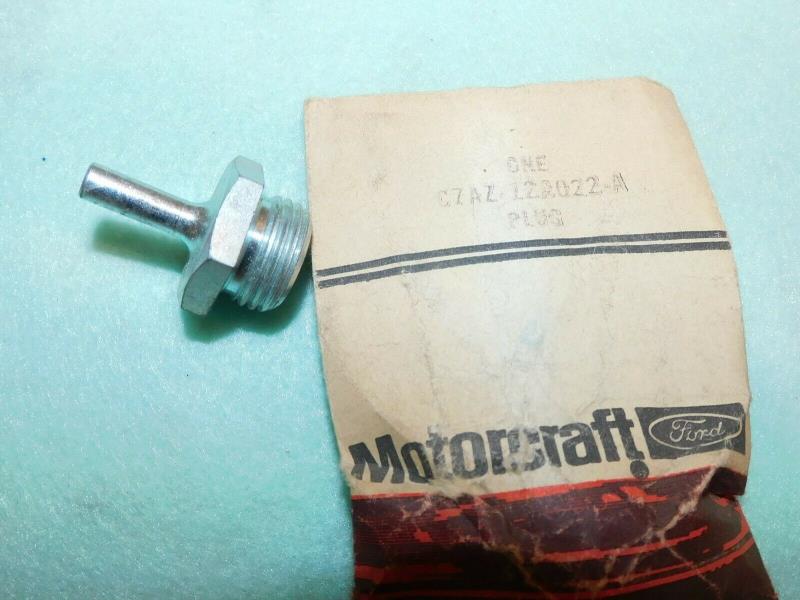

You will need this fitting to run a rubber vacuum line from the DIST to the CARB -
- C7AZ 12A022-A -

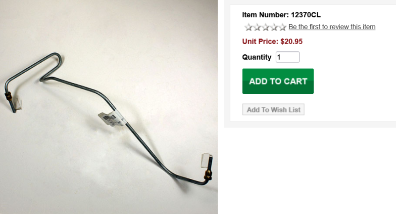

The line that CASCO WILL FIT.;   It is made specifically for a 57 distributor and says so in their catalog, despite what the other poster said. .  I bought the same line and used it in the 57 distributor that I have in my 56 Bird.  I think I used the same piece in my 534 Ford, which has a 312 and a 57 distributor.
By paul2748 - 6 Months Ago
http://forums.y-blocksforever.com/uploads/images/3f17b0f2-dc12-4ac9-8f71-3be1.jpg
This is the line normally used on a 57 distributor    Note the fittings.  CASCO picture
Yours is with an ECZ-B intake and HOLLEY with vacuum port in the same position as the OEM?
That tube was formed for a 57 312 w a 1957/59 DUAL ADV DIS w/ a 1957 OEM H4150 and ECZ-B INTAKE and will also fit a 1955 292 H2140 with a DUAL ADVANCE DIST retrofit? Wonder how many times he will have to re-bend and modify?
They are fancy, one fits all.

That nipple I showed is most likely available at any large NAPA store.
Now why would one buy a made-up line ($$$) to cut? I don't see your reasoning. And you also said it would fit but then said to cut it. Which is it?

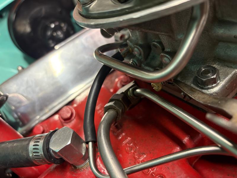

This worked out fine.   I cut off the carb end for the 55 vacuum line and used a hose to connect to the carb.
Getting the carb to idle with no vacuum signal seems to be an issue...................I will start a new thread
