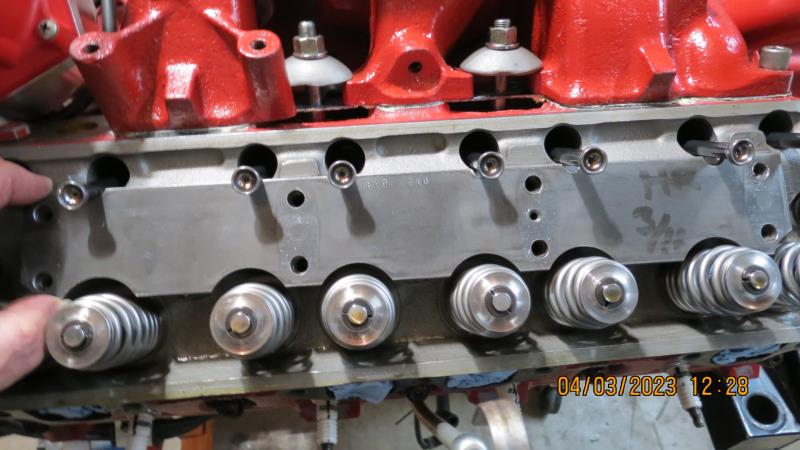

Here is how Ted and I solved the problem on the 2018 303Y for EMC.  Iron head rule, 1.6 Harland Sharp roller rocker arms, Smith Brothers push rods, etc.  Joe-JDChttp://forums.y-blocksforever.com/uploads/images/be20013f-04a1-47be-a62c-a8ff.jpghttp://forums.y-blocksforever.com/uploads/images/5b5fdbc5-6676-47a9-9699-79a2.jpg
