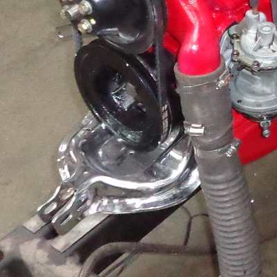

Adding to all that has already been said, the sedan V8 steady rests are not to be confused with the front mounts and the side mounted steady rests that came on the Thunderbirds and just the front mounts on the trucks. Here are a couple of pictures showing the sedan steady rest mounted to an engine.
