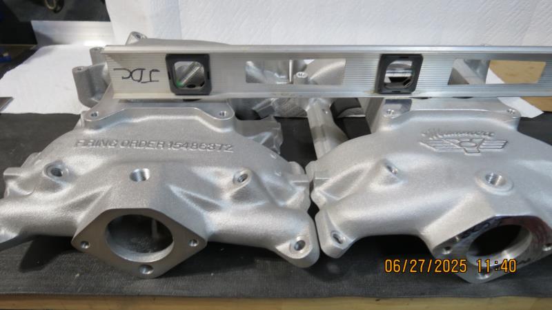

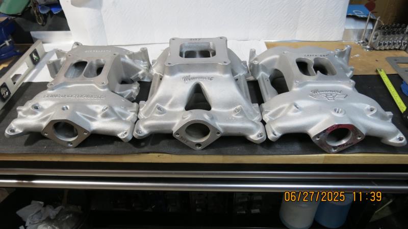

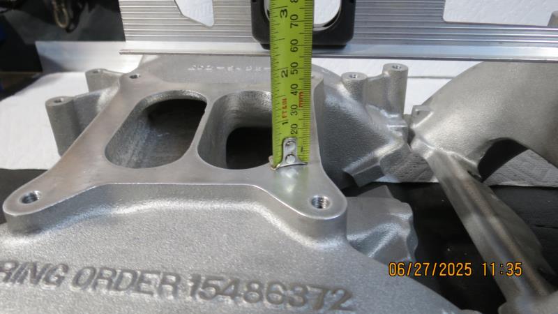

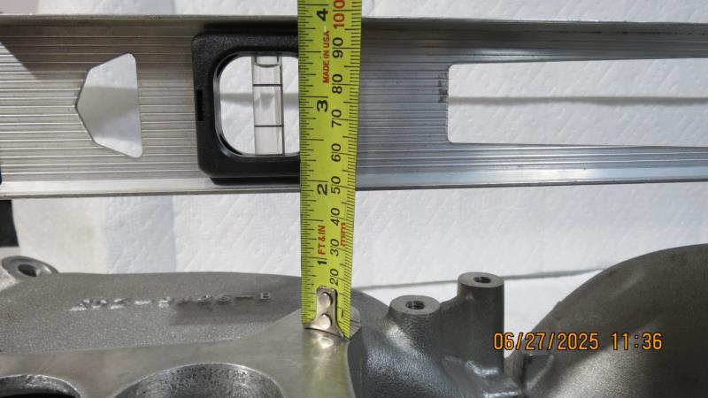

By Old Ironhead - Last Year
How much taller is the Mummert single carb intake than than Blue Thunder?
By Ted - Last Year
The carb pad is ~1¾” higher on the Mummert single plane intake when compared to the Mummert dual plane intake.  The carb pads heights are close to being the same on both the Mummert and Blue Thunder aluminum dual plane 4V intakes.
Thanks, I will allow for about 2’’ more height and measure my current clearance.
By Joe-JDC - Last Year
Didn't realize I still had a BT on the shelf to answer your questions.  Here are a couple of pictures.  On the BT, the pad is not at the same angle as the Mummert DP or SP, and the front of the intake is nearly 1/2" different from the rear. Joe-JDChttp://forums.y-blocksforever.com/uploads/images/010f42d2-0166-46ca-8db9-7b2b.jpghttp://forums.y-blocksforever.com/uploads/images/eec21045-2d02-4388-90f8-75f3.jpghttp://forums.y-blocksforever.com/uploads/images/8fafeeef-30ad-4e0d-ad7a-e726.jpghttp://forums.y-blocksforever.com/uploads/images/321b1719-f3fc-4cdc-b2b2-edb0.jpg
