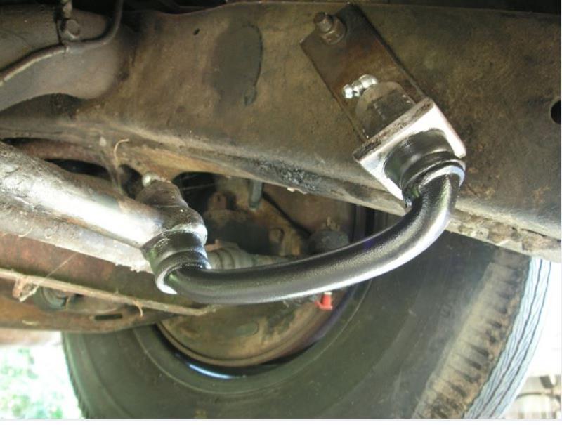

Further on the Idler arm subject: On my 57 car, I recently had a real problem with trying to get grease into both fittings. I pulled the lower nipple & it would pass grease off the car, but not on. And the upper at the frame won't take grease either & when I tried to remove it, it just spun in the fitting & won't come out. Any suggestions?..
I should have specified..it's a car, not a Bird & it's manual steering..
thanks  Paul
To remove the frame mounted bushing, the idler arm assy (MS) has to be removed from the car. Is the frame mounting bracket good or possibly worn or twisted? I would consider a bushing kit replacement if the mounting bracket and actual arm are in good shape.

Is the idler arm loose when you shake the wheels? Is the frame mounting bracket bent? Zerk fittings take grease removed?
It sounds like you need a bushing kit if the arm itself and frame mounting bracket are straight. To replace the frame side bushing, the idler arm has to be removed from the car and done on the bench.

I'll have another look at it for loosness, the car wasn't jacked up on both sides..Thanks kindly for the info & illistrations, appreciated..
