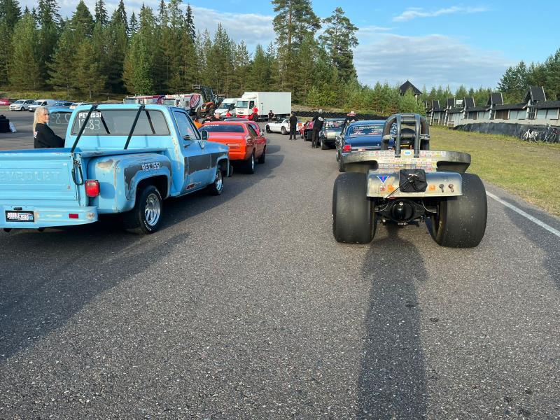

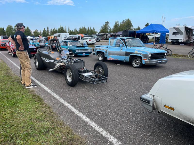

http://forums.y-blocksforever.com/uploads/images/fbdbaf66-14d5-48e2-a4df-bb9c.jpg
Hello from Finland! Been a while, but we are still running our Altered. This photo is from May 2025 and from opening round of the Finnish Drag Racing season 2025 at Motopark Raceway. There i had my first time behind the wheel. Unfortunately I managed to run only two times then as on saturday just when I was at line up, there were a massive electrical shut down that stopped racing for over three hours. Then I run poor 14.205 / 152 km/h and after that a little better 13.759 / 155 km/h after messing badly with trans brake button. I forgot to lift my finger and wondered why I'm not moving despite tree had run down and green light was on.... Okay and then on sunday it was raining all the time and race was cancelled after 2.00 PM.  This time we were running with ECZ-9423-A intake with lot's of adapters and spacers under unmodified 600 cfm Holley electrical choke carb and 1956 distributor with points. My son Roope run in 2002 two races with this same engine with Blue Thunder intake and modified 650 dp and same distributor and run best time as 11.88 then.

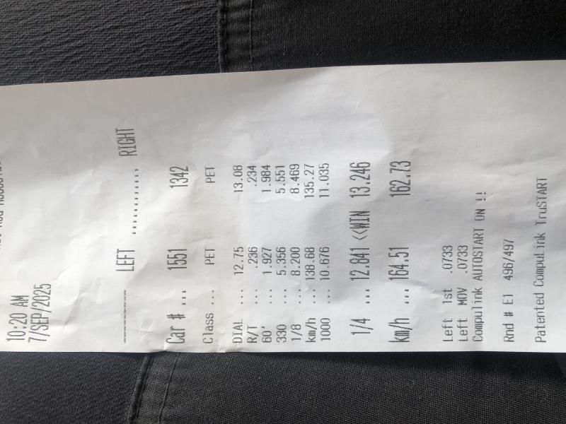

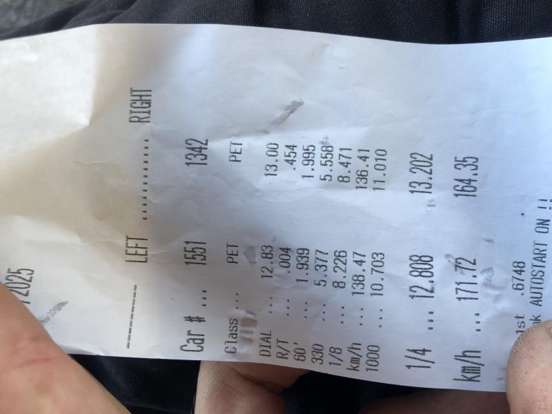

Okay, on September 5th to 7th there is a new chance as I will be racing at the same track for final and fourth race of the season. (I skipped 2nd and 3rd round). This time we try modified 750 cfm Holley and only 2" four hole spacer under carb and maybe we also try brand new HEI distributor how they work. Hopefully we get enough rounds to set things for new personal best... Friday will be testing session and then qualificatios on Saturday and Eliminations on Sunday. Just hope it doesn't rain this time...
By Hollow Head - Last Year
http://forums.y-blocksforever.com/uploads/images/429443e8-369e-4dae-a987-be51.jpg
http://forums.y-blocksforever.com/uploads/images/21179125-4111-4651-b413-1699.jpg
http://forums.y-blocksforever.com/uploads/images/1ff54dde-de5f-427a-a315-1534.jpg
http://forums.y-blocksforever.com/uploads/images/a84fd56a-7de7-48d4-bcdc-5f13.jpg
http://forums.y-blocksforever.com/uploads/images/ff9ef8c6-0cb4-4e97-8135-9391.jpg
So... new personal best is now 13.202 / 164.34 km/h and I lost in first round of eliminations. Just a tad, but... enough...
