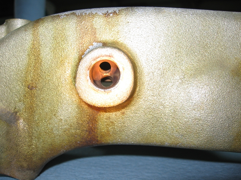

            By Freoway57 - 7 Years Ago
            I recently received intake manifold gaskets and fitted those.  I cleaned up the faces of the heads and intake manifolds until they were sparkling.  However, the problem was still there when I started her back up - no drop off in revs at #8 cylinder when I disconnect the lead.  Spark and lead both good.  I then started spraying around with some "Start Ya Bastard" (a highly volatile engine starter in a can).  Nothing around the manifold to head connection.  I then noticed a change in revs when I sprayed the mushroom-like fitting on the driver's side.  I believe that's a cap to the hot air tube that runs across the manifold to the choke assembly.  Is it possible that the pipe could corrode inside the manifold?  But then why would it affect the intake and not the exhaust?  It's hard to tell exactly where it runs through.  I removed the mushroom cap, cleaned it solvent and sealed it with solder.  When I refitted the mushroom cap, there did seem to be a noticeable improvement.  That is, the revs dropped when I disconnected the lead to cylinder #8.  Does it run through the inlet plenum as well?  Maybe I'll cap the side to the auto choke and fit a manual choke, based on advice received.

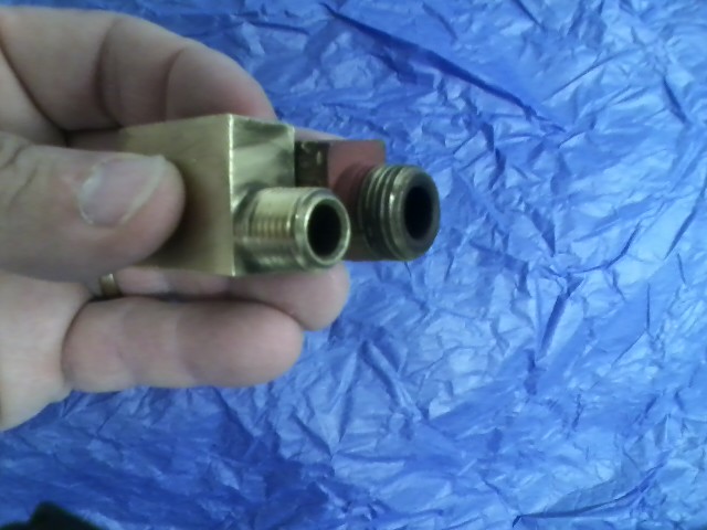

            OK.  That makes sense.   So I shouldn't have blocked off the mushroom fitting.   I will remove the brass fitting on the inlet manifold that connects to the booster, etc. and find and make sure it seals properly with a thread sealer or similar.  I have directed a propane spray (with wand) around it when the engine is running but it doesn't appear to make a difference.
            Just thought I'd provide the result of the original post.  After refitting the intake manifold with new gasket, the intake manifold improved slightly.  My first run indicated that I may have solved the problem of poor contribution from cylinder #8.  Things definitely improved as the manifold vacuum reading increased into the low side of a normal reading.  I then rechecked all other vacuum fittings - including the brake booster.  I discovered that the booster diaphragm did have a hole in it which was a big part of the problem.  Interestingly, the first time I plugged the booster pipe, the problem didn't disappear, since the intake also had a leak.  Given that there were two issues - an intake manifold gasket fault and a booster diaphragm leak - it makes it harder to diagnose the problem.  One naturally assumes there is one fault, not two or many!  I have previously worked in maintenance engineering, so I'm annoyed I got fooled by this issue of multiple failures.
