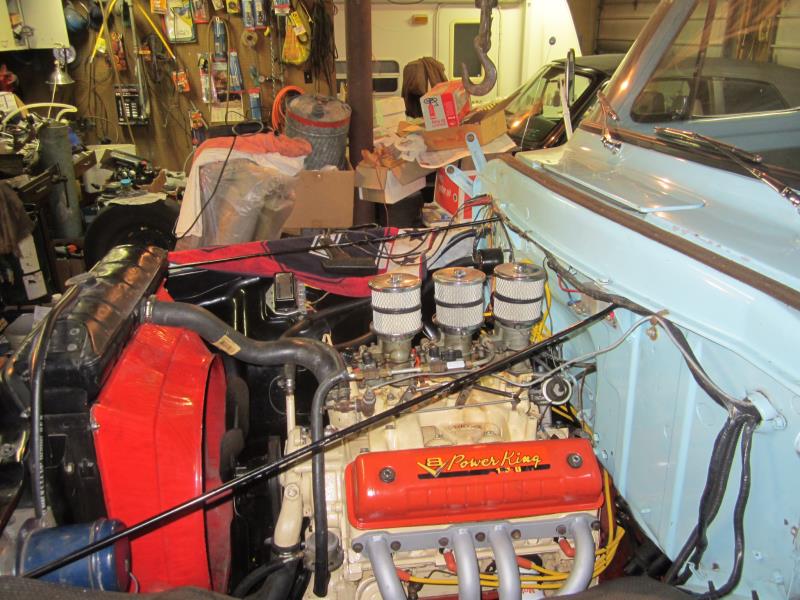

By pintoplumber - 7 Years Ago
I’ve been running this since 2003. If you look closely, I have 3 ball valves to shut off the gas. The 1st year I ran on just the center carb. You can leave the linkage loose so the outer carb butterflys don’t open. You need a ‘57 or newer distributor if you’re using all 3 carbs. This is a 239 that been bored and stroked.
